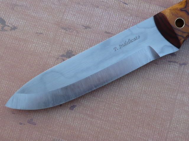

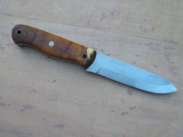

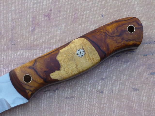

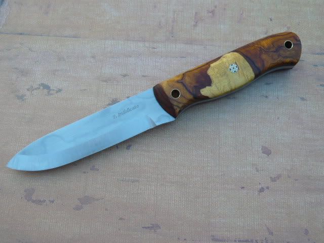

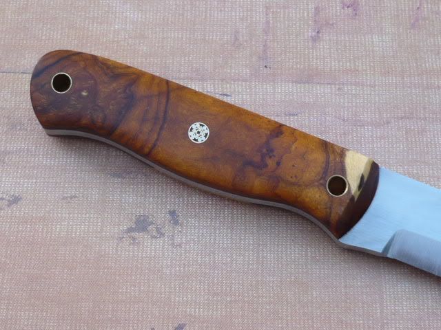

I just finished up my first try at a scandi-ground bushcraft style knife. Thanks in advance for any comments or feedback!
Specs:
- 3/16" 1080 steel
- flats are hand sanded to 800x, etched, and polished to show a 'natural' hamon (no clay was applied before quench)
- AZ Desert Ironwood Burl scales
- 1/4" brass thong tubes (front and rear) and mosaic pin
- ~4 1/4" blade (tip to front of scales), just shy of 1" wide, and ~8 3/4" OAL

Thanks for all of the good feedback, guys; I appreciate it. If I make more, I will bring the edge bevel back closer to the handle scales.
I meant to update this post with these awesome photos RyanW sent me a while back and I totally forgot (sorry, and thanks again, Ryan!)
