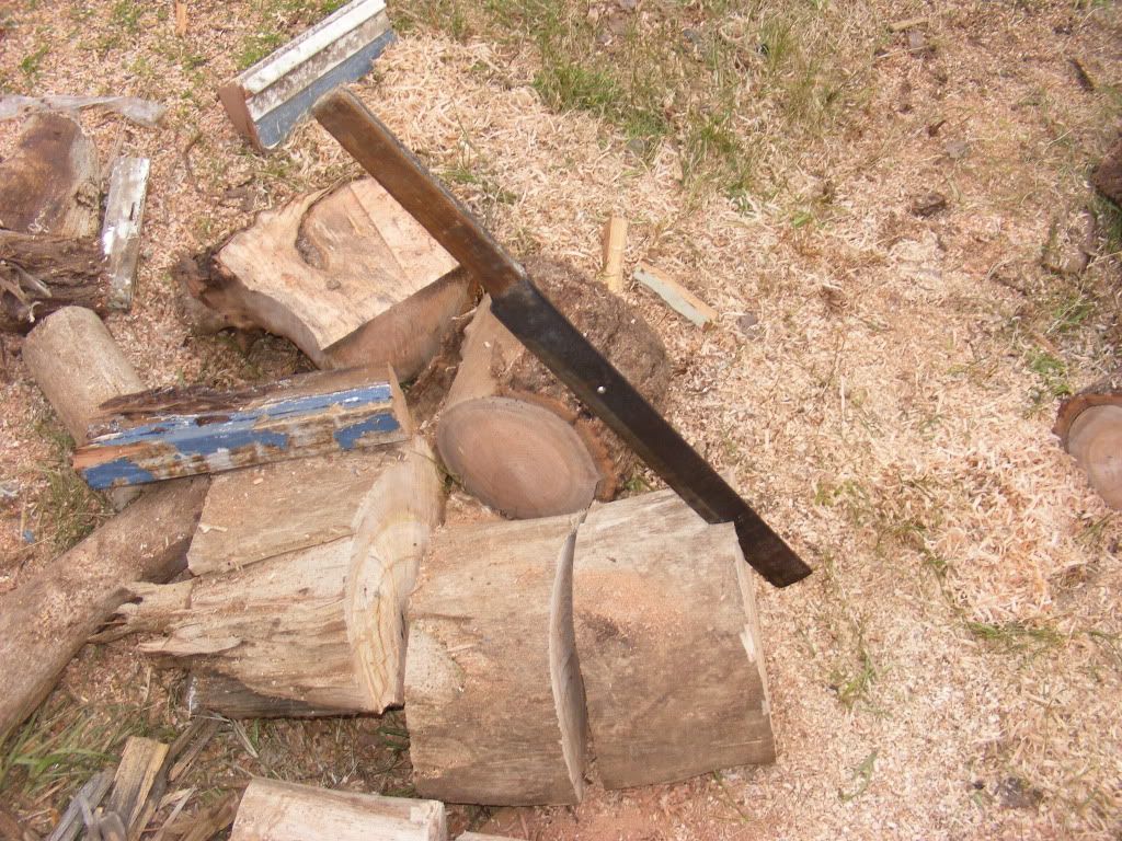

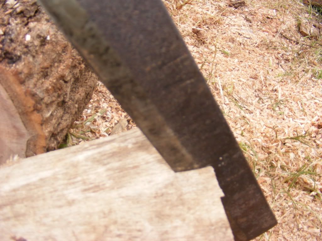

I has a machete with a 1/8 inch thick blade :)
its not *that* heavy ...
the grind is what I considered convex ... but its only convex for the 1/2 inch it took to turn the natural blade flat to a shaving sharp edge , an edge that will take a bit of use .. Im not sure if it is or isnt a convex or part convex or whatever now tho ... dam technicalities ...
the machete is 28 inches long , 19 1/2 of that is blade ,its got enough handle for a 2 handed grip , it can be some fun .. my first ever blade I made ( before I knew I was sposed to start small cos big blades are too hard for beginners )
in objective terms of lifting pounds of iron off the ground, 1/8 inch isn't that heavy. In terms of a machete, it's considered a heavier blade. Most of the machetes I've dealt with coming out of central and south america are on the thinner side of 3/32.
In fact, I had an email from a purist telling me I shouldn't call my machetes machetes when they aren't "really" machetes because they are too thick and heavy. I don't agree with that, I think that environments like where I'm at call for a mid length (or even a bit short) heavy bladed machete.
But there you have it. In "machete-speak" 1/8 inch is heavy.
I was mostly joking
even the 24 inch machetes I have out of South Africa are about only half as thick , one i Have from the Philippines is in in one place about 1/8 across the spine .. for about an inch if that . I spose itll forever remain a sharpened ford leafspring :)
