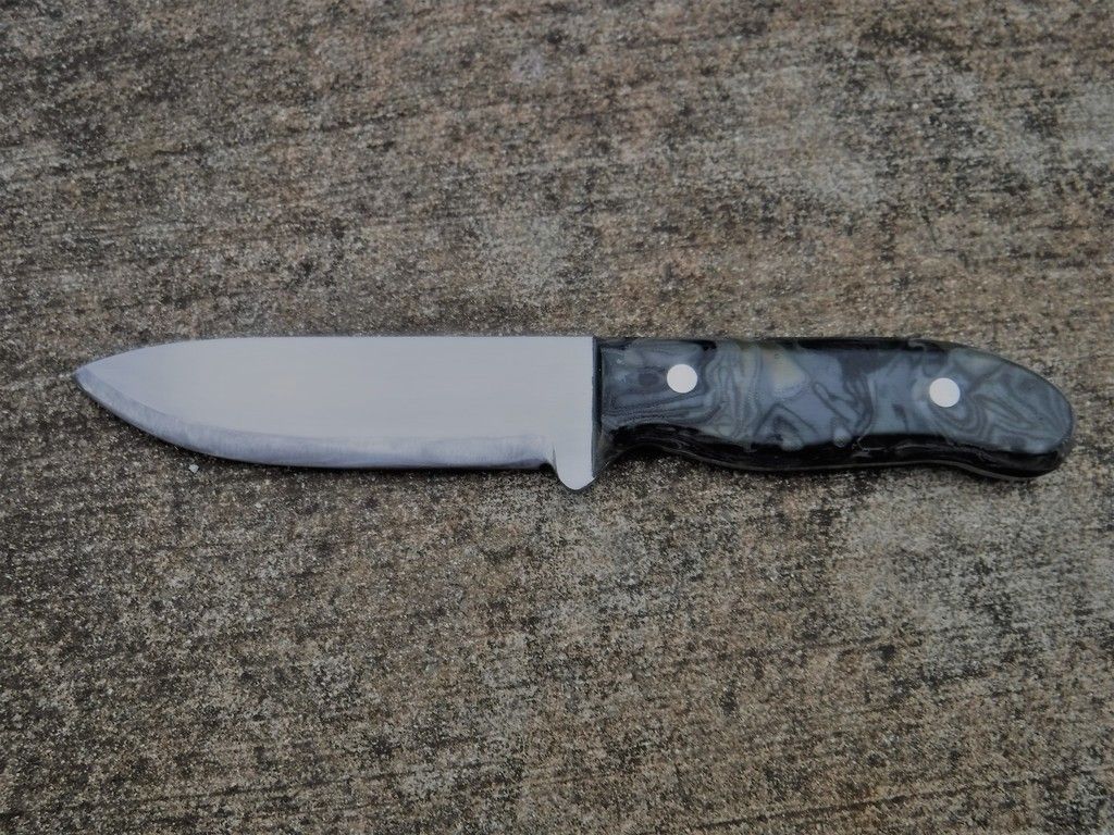

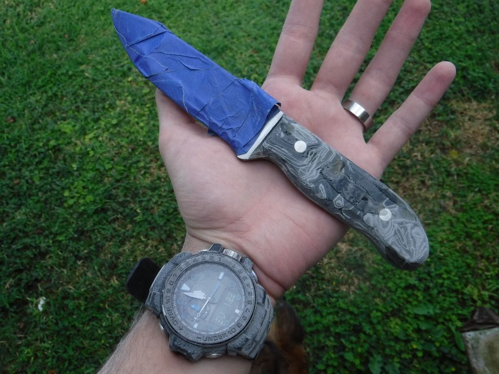

This is only the second knife I've made... I learned a lot from this knife!

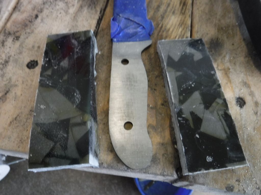

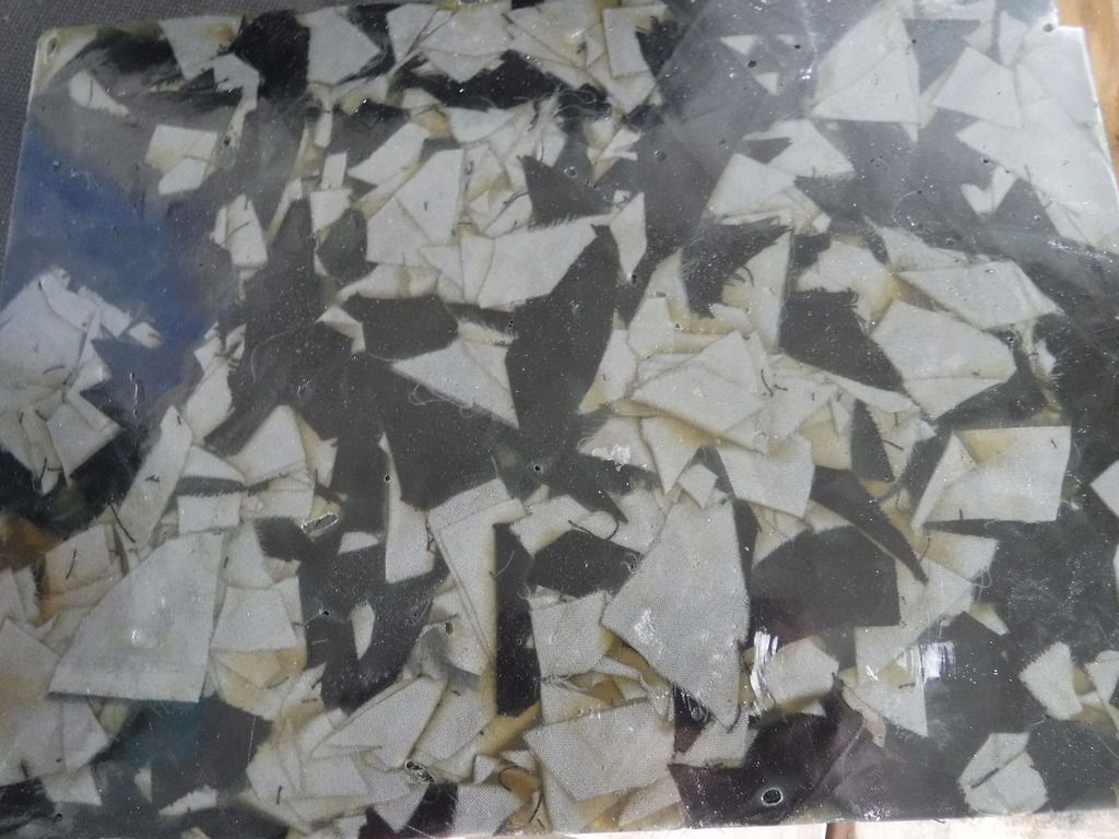

-I need thinner resin for micarta, because I got some bubbles in my handle!
(I probably wont make my own anymore)

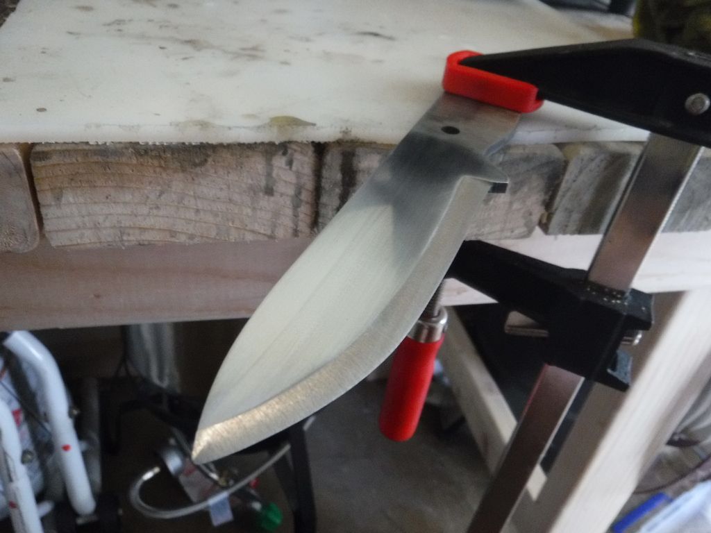

-Don't try and free hand a scandi... that's why I had to make it convex haha.

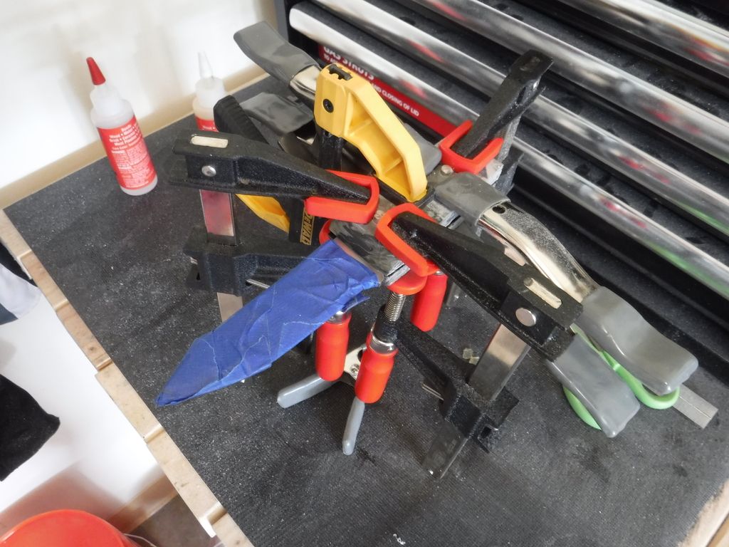

-Level your handles before you epoxy them (theres a small gap towards the bottom of the handle)
-The choil doesn't look good right there
O1 Tool Steel
OAL 8 - 7/8"
