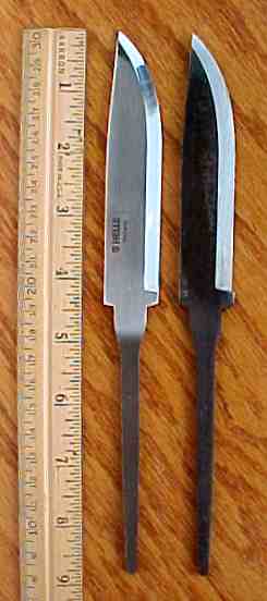

One thing I've wondered on those Nordic style blades is the narrow bevel. Like these:
Looks flat ground, but such a thick cross section! Doesn't appear you'd get many sharpenings off those. Or are they hollow ground on a 4" wheel? I may be Norwegian, but I never could figure out that grind.

About those bevels, that's a traditional Scandinavian grind and there usually isn't much of a secondary edge bevel. Ideally the whole bevel is laid flat on the stone when sharpening, but in practice it is tipped up slightly to maintain the initial edge and the whole bevel is laid flat only when a new edge needs to be worked onto the blade.
Some Helle blades are lamintated ss, with the outside of 18/8 ss which is very corrosion resistant. See Ragnar's site listed above for ready made blades. Many of the Scandinavian grind blades have a shallow hollow grind on the bevel and will get very sharp.
