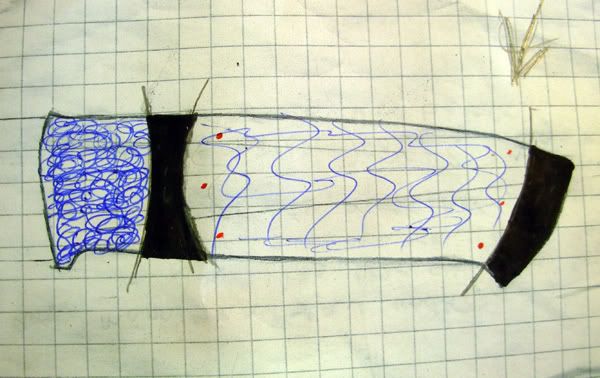

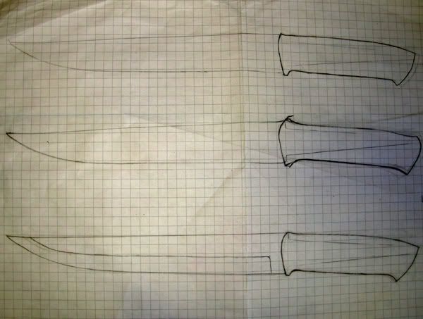

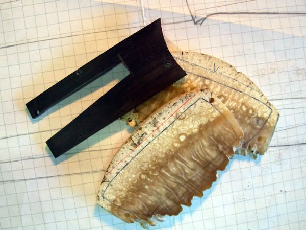

This is the very artistic sketches of the knife.

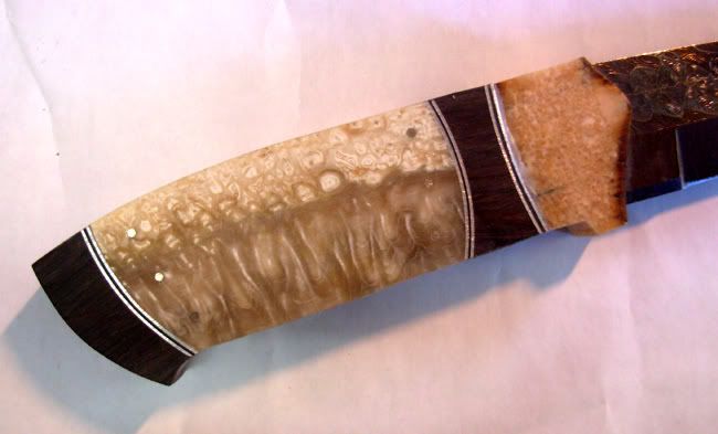

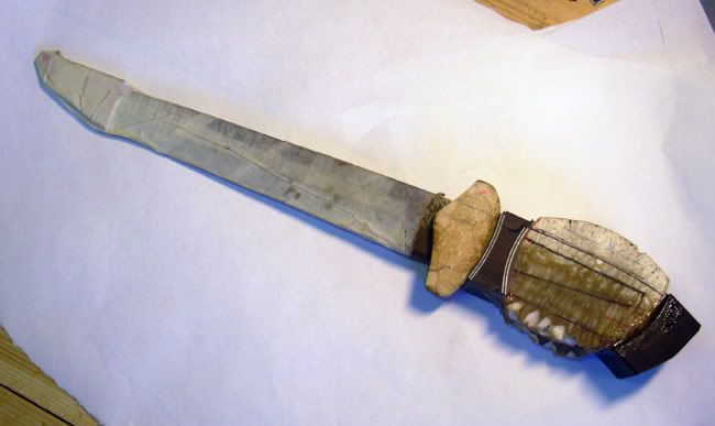

Fossil walrus ivory bolster

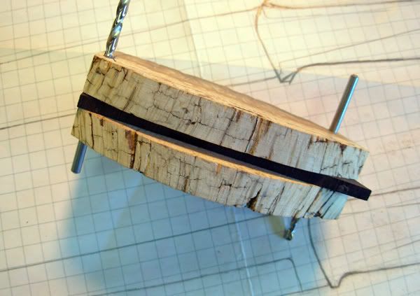

grenadil

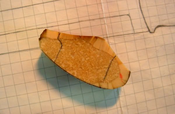

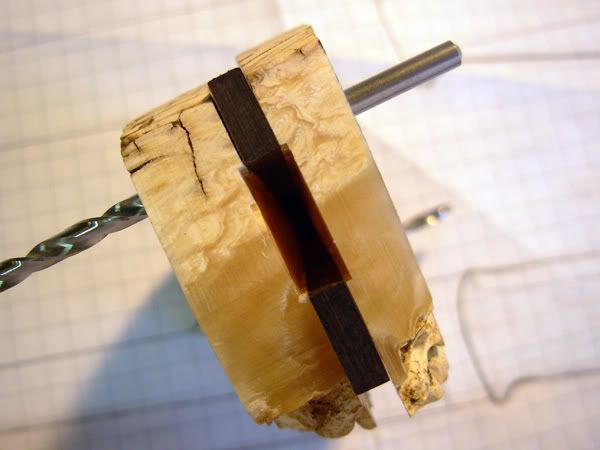

The main/middle piece is made of muskox scales with a grenadil liner.
Fits perfectly!

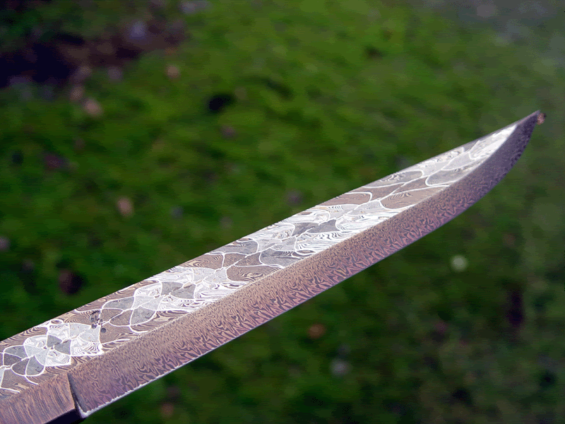

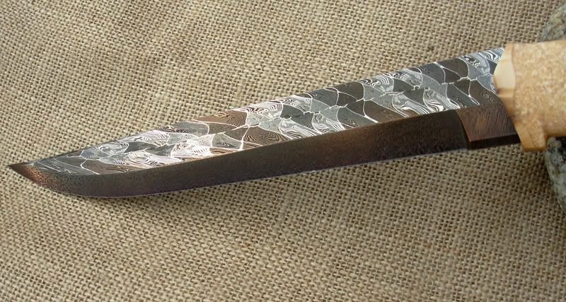

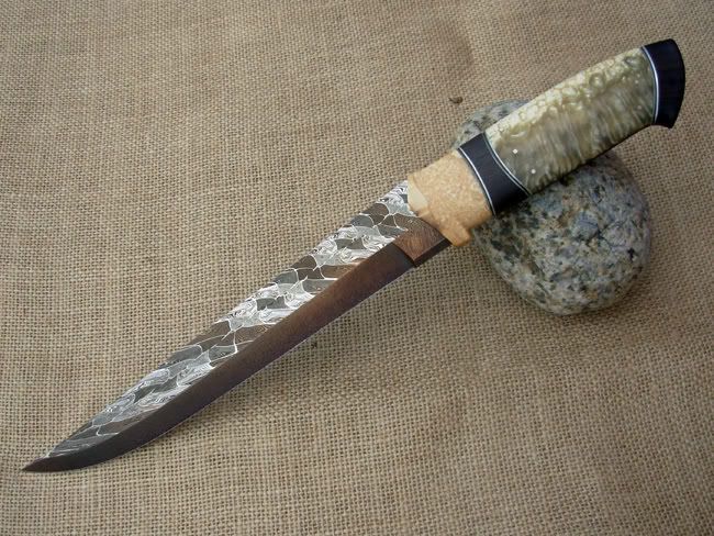

And a big beutiful mosaic damascus blade by Robert Matsson, total lenght 23 cm!

The knife is glued with epoxy.
I've profiled the handle...
close up

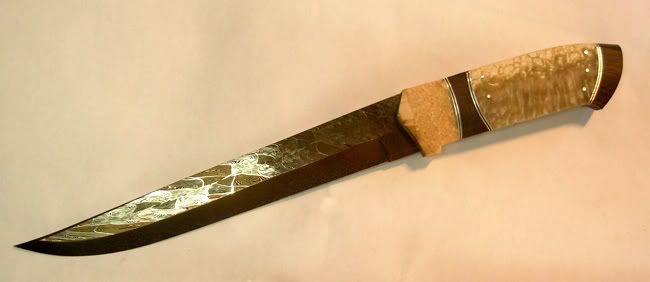

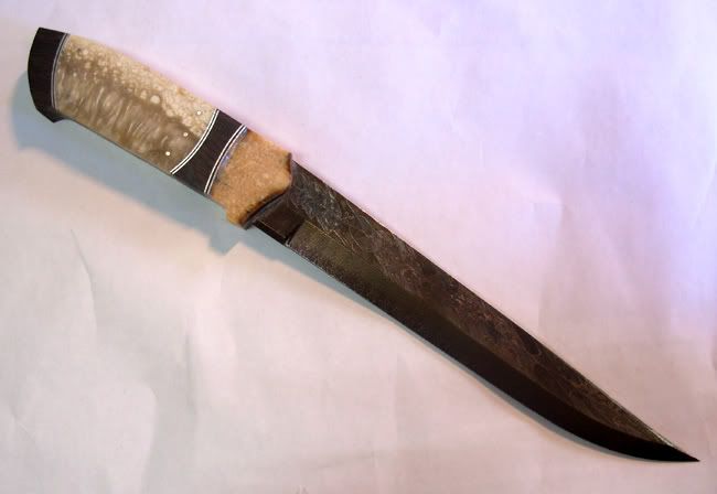

The finsihed knife
I've sent this knife to a competion that is held in Sweden next weekend...

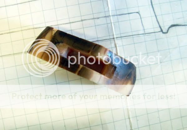

Very nice knife! If you don't mind me asking how did you get the metal spacers to curve around the handle pieces perfectly like that...is it just thin enough so that it can be bent when press fitting everything together? Great job!
I was wondering the same. Very nice piece!

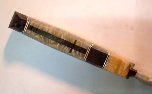

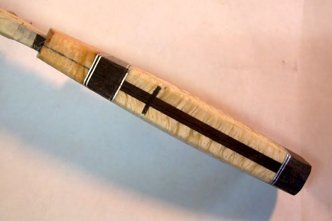

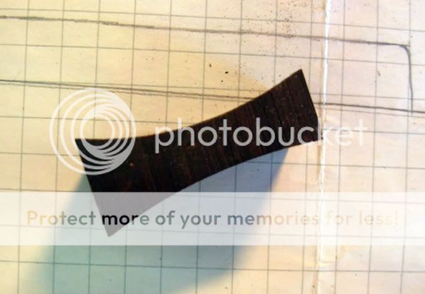

Very nice knife. I particular like the musk ox slabs and the damascus. I have an additional question. Why is there a "t-section" in the wood on the bottom of the handle? I can imagine why but I like a technical explanation please.
Yes, the metal spacers are thin enough to bend them when fitting it all togheter. In this case I've used pewter but the same works with brass, nicklesilver, bronze, silver... But they have to be thin enough. I mostly use spacers between 0,4-1mm thick.
Marcel
I'm not sure I understand what you mean with the "T-section". Do you mean why I got a bottom end piece of grenadil, or is it something with the grenadil "liner" between the muskox scales?
