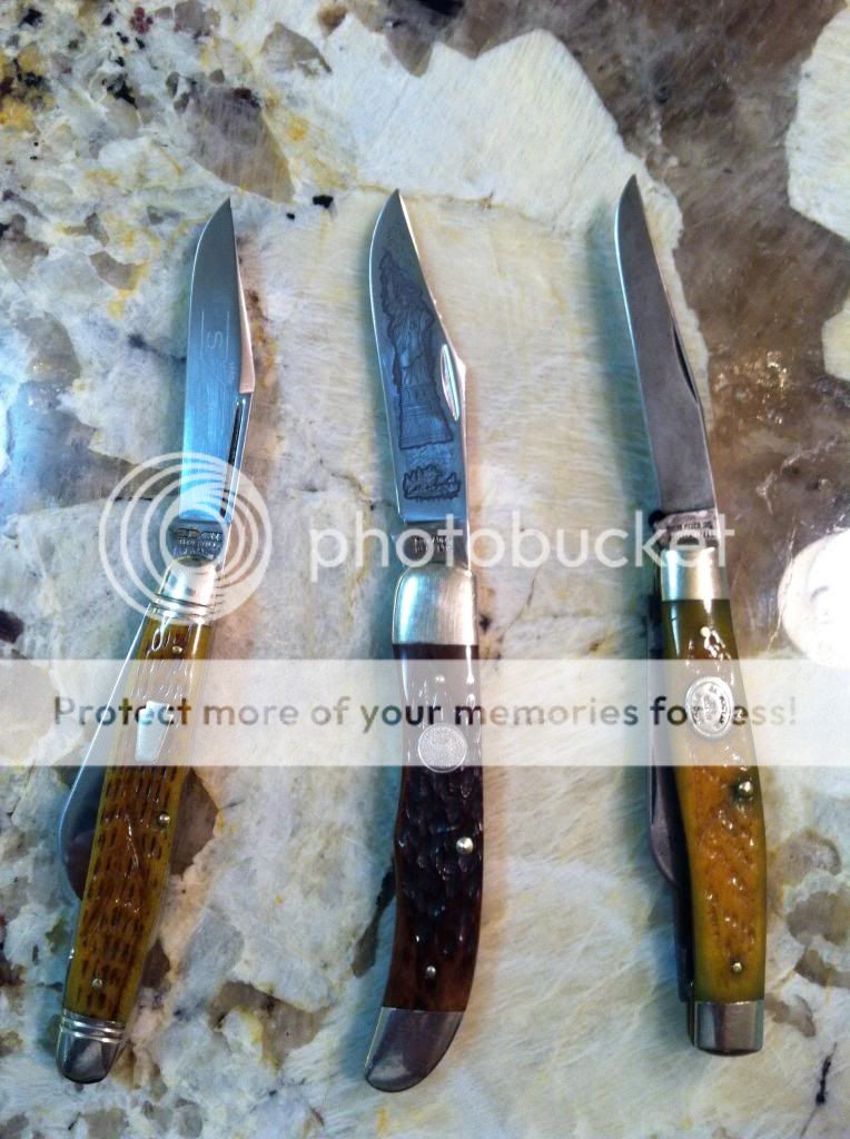

I have two of the S & M series IX ATS 34 knives, the gunstock and stockman. The steel on both of these knives sharpens considerably easier than the D2. Both the D2 and ATS 34 are excellent cutters. Both steels are part of my EDC along with 1095 carbon.
The attached photo shows the S&M stockman in ATS 34 (left), and the Queen made Moore Maker stockman 5301 with 1095 carbon steel (right).
