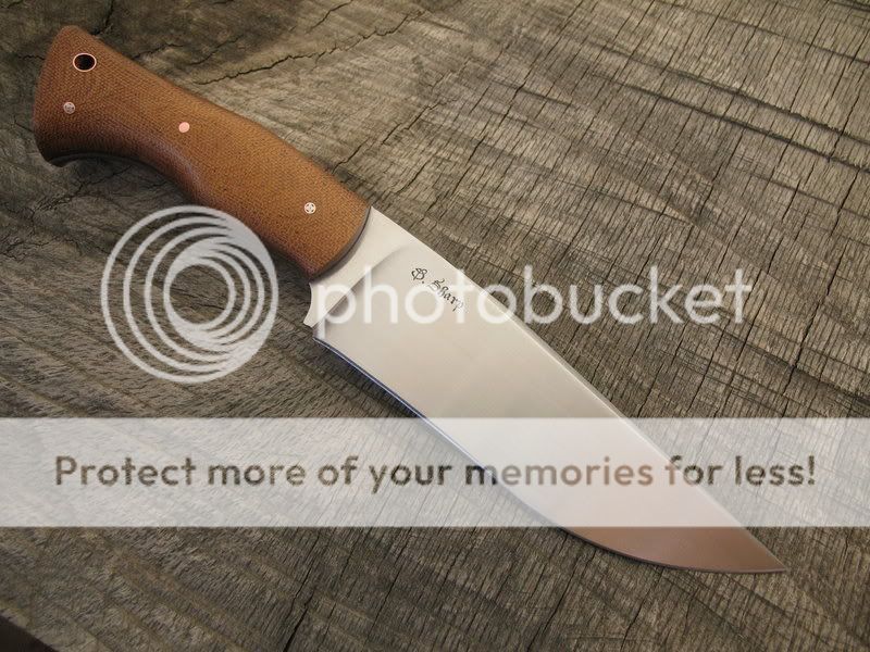

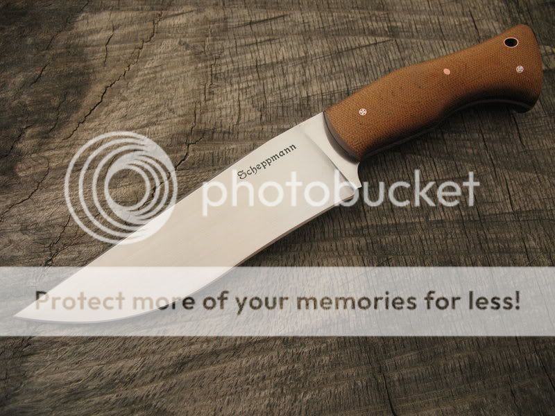

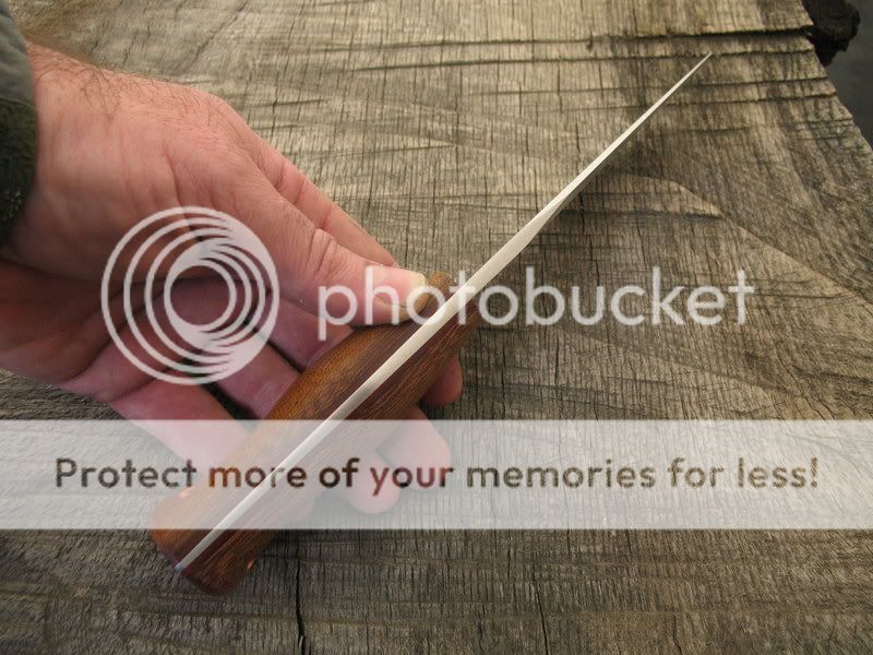

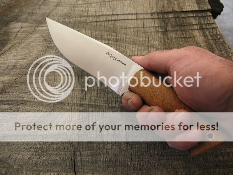

So after seeing this thread:
http://www.bladeforums.com/forums/showthread.php/907879-Magruder-RyanW-Collaboration
We were inspired to do similar. Robert and I collaborated on the design. I profiled and tapered the tang, he ground the blade HTed and did the hand sanding (sucker), and I received it back to do the handle.
It is A2 at 60.5HRC flat ground with a sharp clip. The handle is some vintage canvas Micarta with ruby G10 liners and copper/stainless pins and lanyard tube. Tip to butt measures right at 11".
Thanks for looking!
