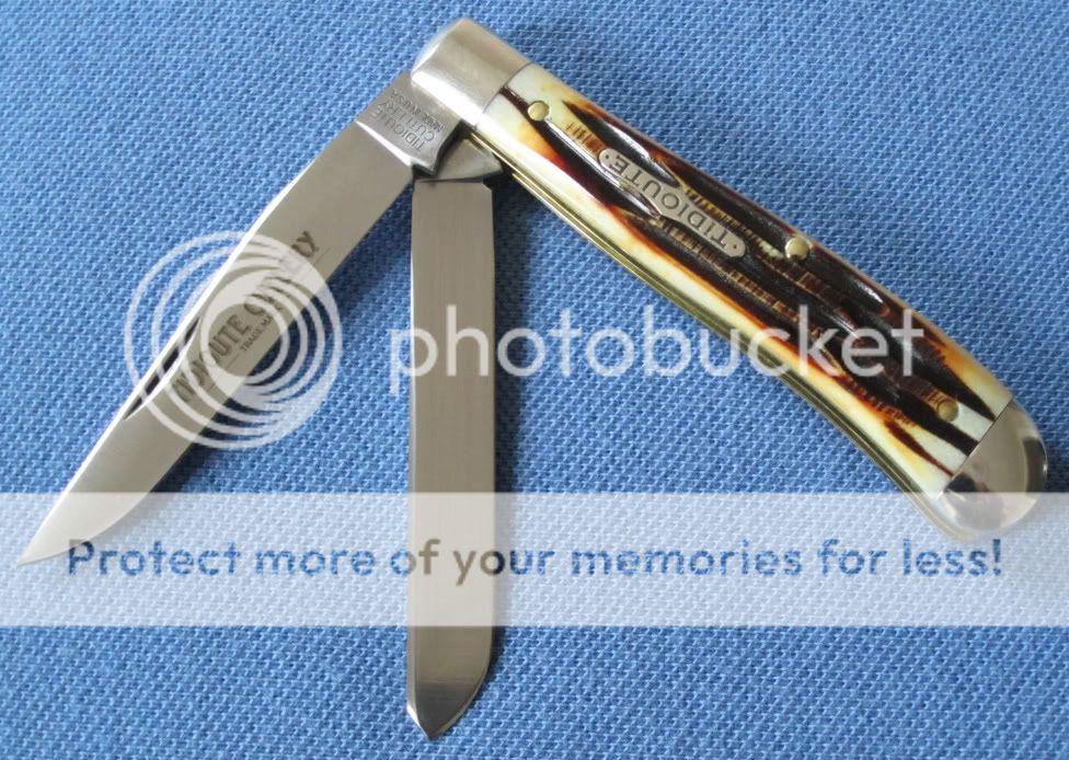

Stag Bone or Bone Stag (bone jigged to look like stag)
pumpkinpatch2.jpg~original
