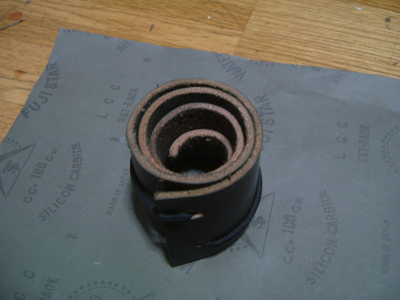

Stitchawl
My instant field strop with green compound(rough side only).
I usually hook paracord to right foot finger and pull another end with left hand.
Smooth side is also available for finishing.
