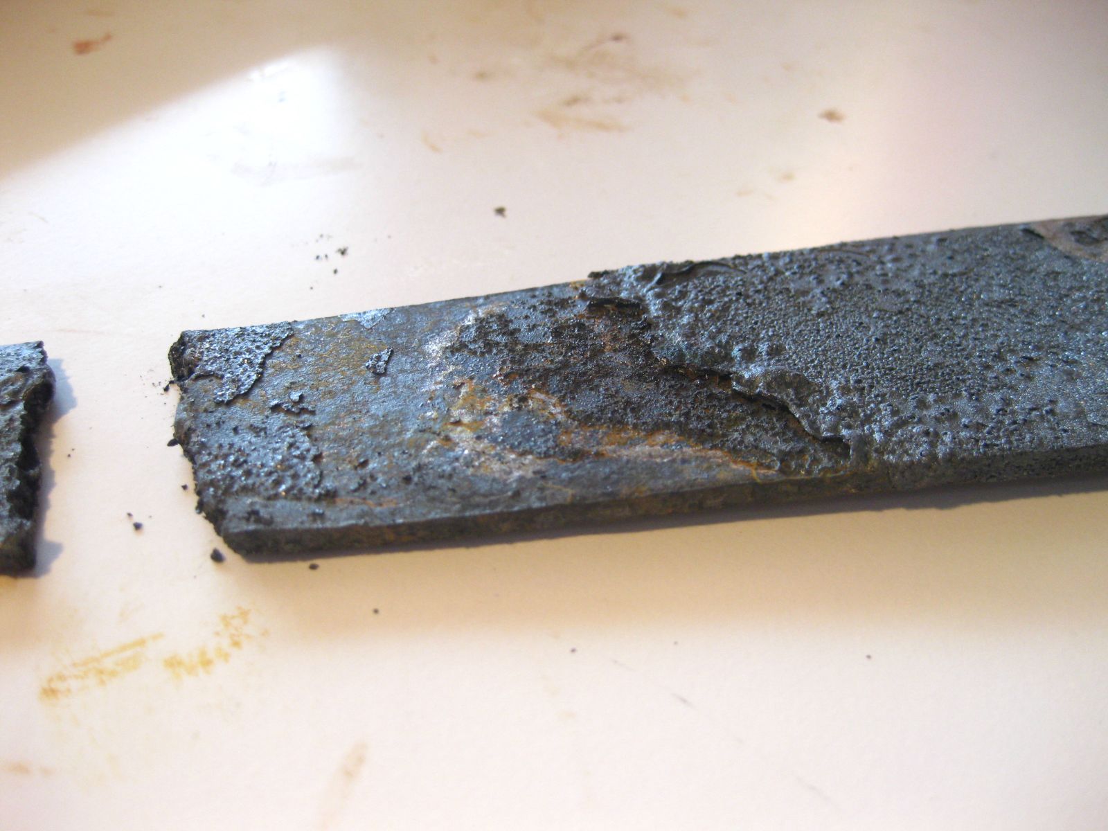

I have access to the shop at my community college again. They have a forge and power hammer there which I like to use. Two questions:
  • The forge runs really nasty. There is always gunk build up. I have no idea what it is, but apparently it's something to do with the crap lining the ceramic lab tech's put in the forges. I can do nothing about it. Is this threatening to the steel, possibly oxidizing it too much or doing other stuff?

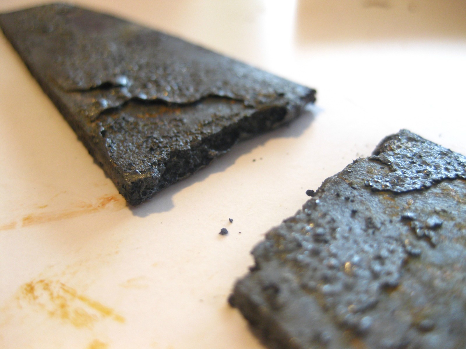

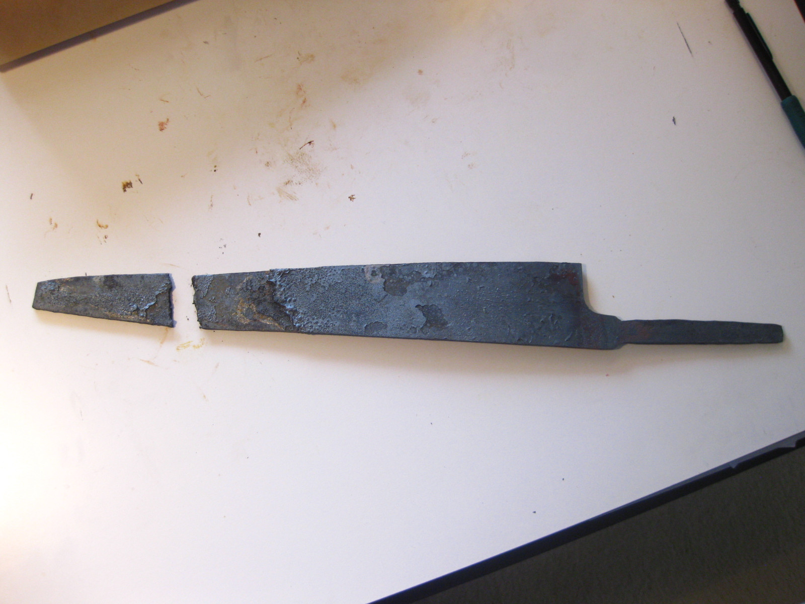

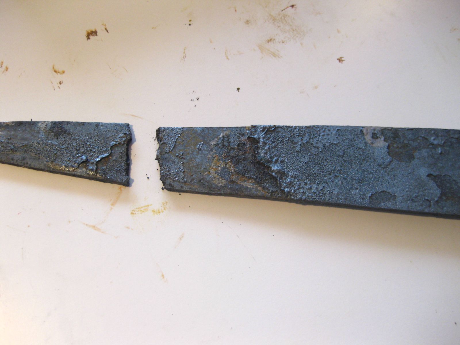

  • -Yesterday I used the forge for the first time in about a year. It normally does not run that hot, maybe 1900 degrees F max. When I used it yesterday though, it was going way, way hotter than what I was used to and I carelessly burned a blade in half (I think it was due to a rainy day, or something). The tip crumbled off in the forge. How much if this blade is recoverable? Not all of it burned, but you can see how it was affected in the pictures.
I've had that happen before when doing outdoor demos, rain will screw stuff up and the forge will burn too hot. I think the atmosphere becomes much more oxidizing at these times, and it sounds as if the forge chronically burns oxygen rich. It's a venturi burner, right? If you can, add a choke plate to the burner and tune it as needed so that your work doesn't scale up harshly. I've used a bent piece of slotted tin in a pinch, over the venturi. Or, maybe you could retro it to have a blown burner...
I'd scrap the blade, it looks as if you may have massive grain growth in much of it, and steel is cheap at any rate.

And I'll just throw this one out, or give it to a classmate to destroy it.
Bummer? I'd ditch it that mess and start over with a new piece. Looks like you got some good hammer control and shaping done though!

Your forge right now is running very oxygen rich and is probably making white fuzzy stuff grow on the insides as it burns up the lining and the burner flare. Any blades forged in it right now will probably be very poor. Fix it before you make any more.
Thanks Stacy, that's exactly what I was concerned about.
How bad does it effect the steel overall if it's oxygen rich?
In the photos you can see that oxygen was attacking the $%!# out of the surface, from the outside inward. As long as the steel was not overheated in the process, under the gnarly scale it should be salvageable if you had to... if the blade is burnt in half though, that's a good indication of massive grain growth. I had an embarrassing moment once at a trade fair demo, forging out a bullet cutting knife (think straight razor type blade) for a guy standing right there... a little rain was falling, and in the daylight I couldn't judge the forge heat spot on. I knew it was running junky, too much scale and all... I finish the tang and do a little side tap at a black heat to correct it straight, and the blade just snaps like a toothpick. Astonished, I picked it up and looked at the grain- kind of looked like cast iron. The guy stuck around and bought the next one though, it's been 6 years and he tells me it still works great for him...
