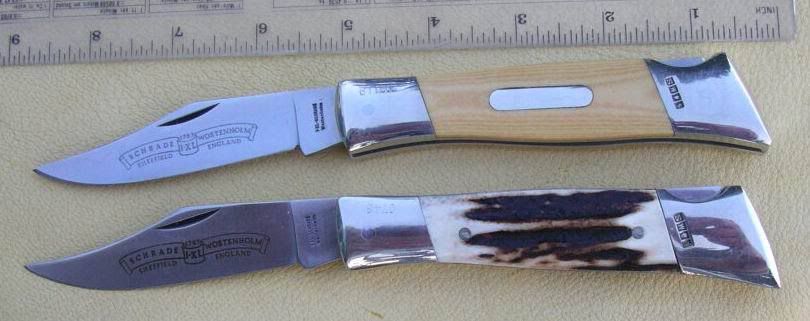

here is a rather poor pic. of 2 of mine for comparison. roland
