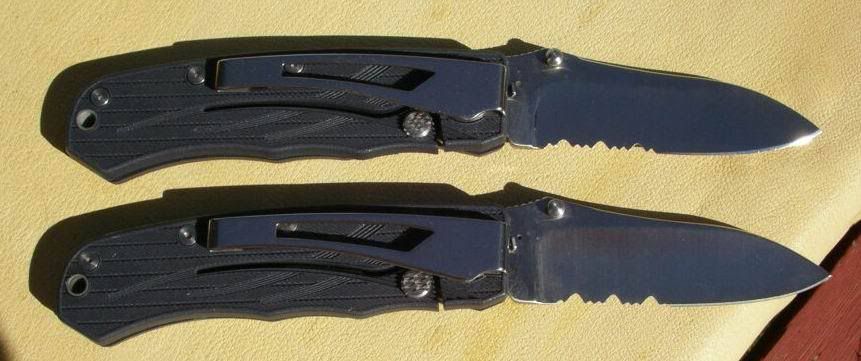

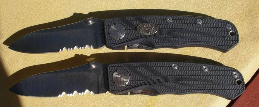

my SLW2 "Limited Edition" knife has arrived. it is identical to my other SLW2 which has no shield.
i have no idea what is "Limited" about this edition. roland
G'Day Roland,It's Limited to the number that had Limited Edition Shields mate!Told you Schrade were regular tricky dickies with their marketing....having said that those are great knives and are generally undervalued. If we ever get this Schrade swap section working the first knife I will personally put up is an SLW1 to give someone a chance to feel the BG 42 steel model as I think they come up on the Bay about as regular as Rocking Horse Poo now....How we going with the numbers for the swap deal anyway?? Hoo Roo
