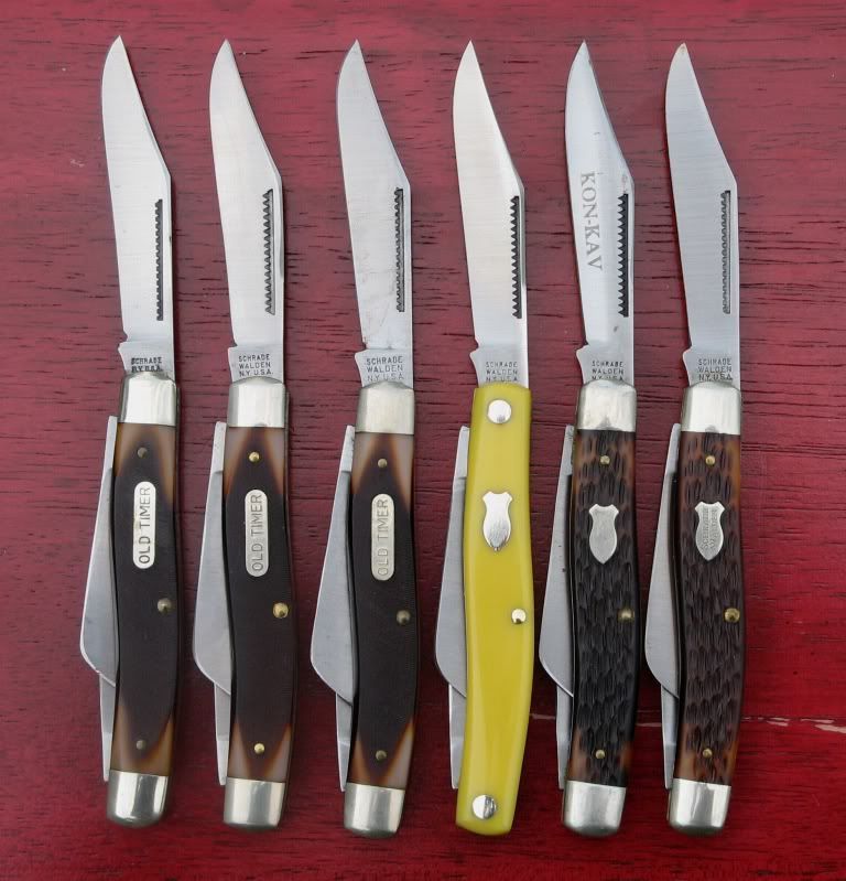

Nice tip on the swedge cut, 300Bucks! Another way to tell (if you can't see the swedge) is the distinct thinner S-shape handle curve on the Schrade. The Cami's and post 1970 Buck 301's were shaped a bit different, a little thicker, and not quite the S curve.
Looking at poor quality pics, sometimes one can make out that handle shape to help identify a Schrade version, if the stamps and swedges are not visible.
Schrade 301 and 118 personal from the 60's
The frame is the same as a Old Timer 8OT, or any of the Schrade 4" stockman in that pattern family. Additionally, the Schrade 301's always had three pin construction on the handles. Many of the Bucks only had one center pin.
Back in the day, the Schrade blades were hand finished, so the swedge would vary from knife to knife.
