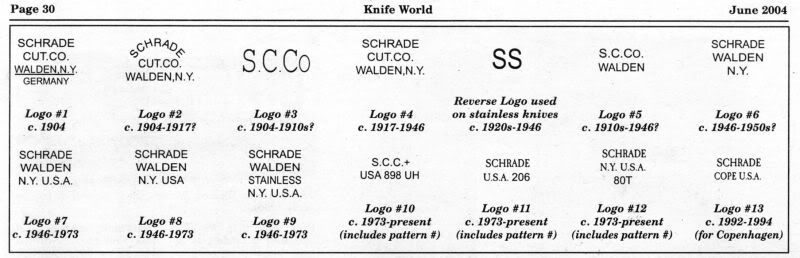

To add to Rusty's references... for Schrade knives post Schrade Cut Co.
The stamp Schrade Walden N.Y. preceded Schrade Walden N.Y. U.S.A, which preceded Schrade N.Y. U.S.A, and finally ended up being Schrade USA. The progression did not necessarily follow exact years from pattern to pattern. The oldest stamps were found on more than one blade per knife, and the oldest ones did not have pattern numbers stamped on the master blade. The pattern number stamps were on the back side for a while beginning with some Schrade Walden N.Y. knives, continuing on most Schrade Walden N.Y. U.S.A knives, and ending with most patterns stamped on the front side on the Schrade USA stamps. A Schrade N.Y. USA knife might have the pattern stamped on either side. Of course, there were exceptions and variations from time to time, so future collectors would have something to discuss.
A somewhat accurate chronological chart of the stamps
