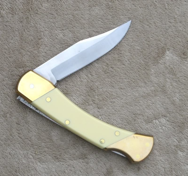

Don't forget that the main blade had Schrade Scrimshaw with the S used for both words. I am at work or I would take a picture of one of my knives. I did find a Frontier scrimshaw that only has Scrimshaw on the blade.

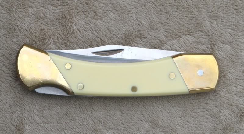

just wondering on the knife that thawk is showing a scrimshaw 4 pin LB 7. does this mean he has a early LB 7 scrimshaw unprinted or did the scrimshaw keep the 4 pin design longer than the normal LB 7? for reasons of tighter handle fit?
The 4th pin was deleted on all LB-7, then shortly reinstated on all with the smooth Delrin covers. Yes, the smooth covers didn't lay completely flat without the 4th pin. I posted the dates of the changes here somewhere if you search. I don't remember off the top of my head.
I am home and would like to show my Frontier Scrimshaw. it is a 44 series (blade is a 4435) and I have a normal 4432 with it.
