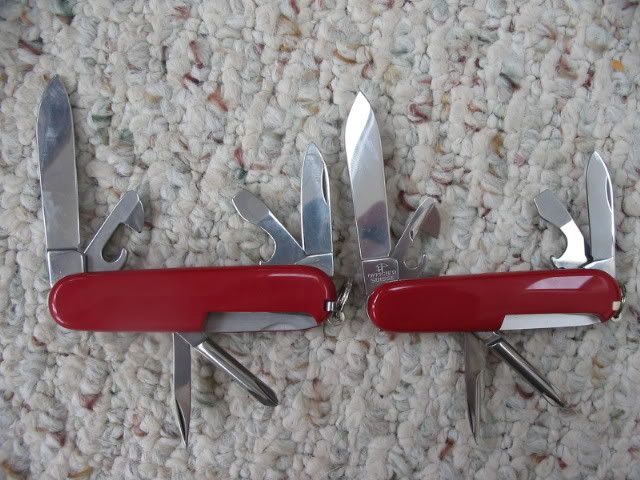

I wrote a little bit a week or so ago talking about the German made Imperial schrade Sak style stainless knife. I recently recieved 2 that I bought off of ebay The CN61 Mercury and the CN81 orion. One for $15.00 and one for $10.00. I usually carry a victorinox super tinker knife so im pretty much comparing it to that. Which let me first say it is very hard to beat a victorinox as far as quality of a knife and price. So price wise the schrade when you can find them which isint too hard is a bit cheaper. Blade snap seems to be pretty good and fit and finish are nice as well. tooth pick and tweezers are nice and tight in the knife. The awl on the back of the schrade is very dull -vs- victorinox being very sharp. Factory edge on the schrade blade is ok sharp but a very small edge, somewhat similar to the vic. Im gonna try over the next week or so to carry the 2 and give some more honest opnions and comparisons. Anybody else ever carry one? Just curious to see what you guys thought. Dont want anyone to think im badmouthing the vic's cause I carry one and love it, just doing a side by side to see where schrade stood with these knives- Joel

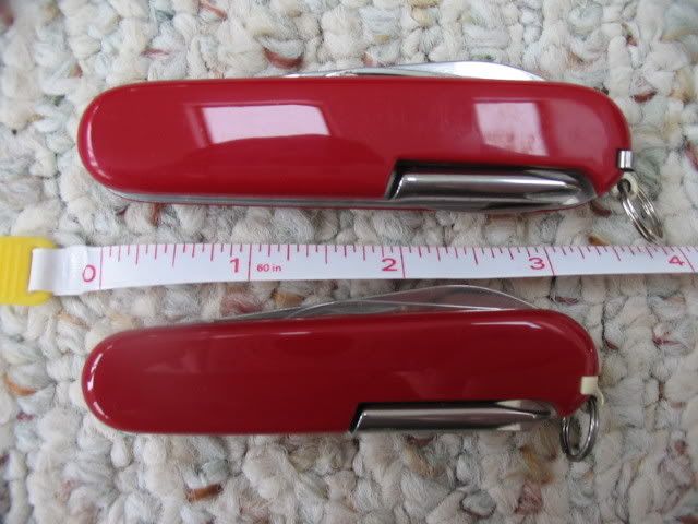

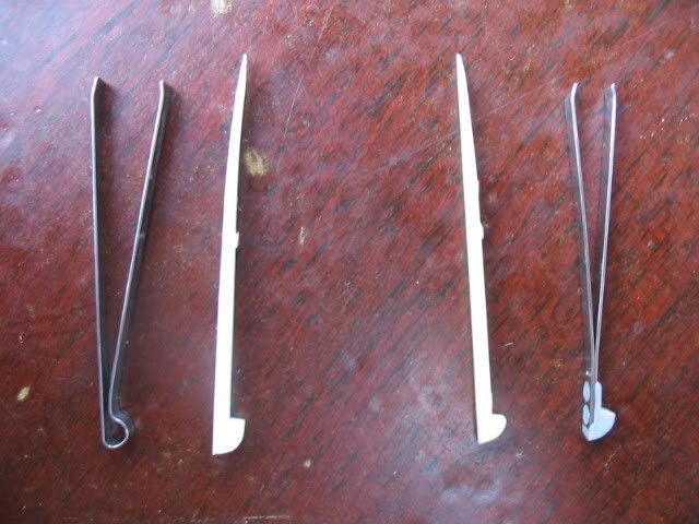

I'll start with the side by side comparison... anyone know which one is the schrade, without pulling out yours . I'll say this so far they are identical with a few minor differences and I mean minor, length being one and tweezers being two so far.
Ok well the bigger of the 2 knives is the German schrade. The tweezers and toothpick on the left also belong to the schrade. The longer I compare and use these two they are identical other than size, snap on both is great, the build is nearly identical and one seems to be as durable as the next.
Good review and comparison so far. I have several of these U.S./German Schrades but no Victorinox/Wengers to compare them to.

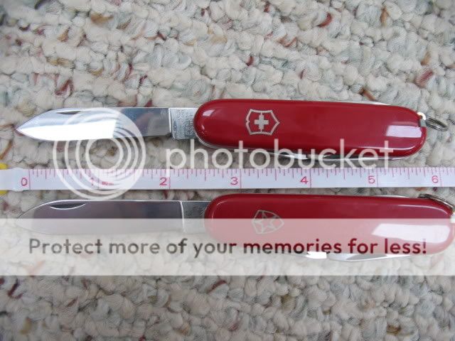

The blade grind is a little bigger on the Vic, meaning a little larger edge. So yes I would say the same as you, I wasnt super impressed with the edge on the main blade of the schrade but that can be fixed like you said. And the same goes for the smaller blade as well not as good of a grind/sharpening as the vic. I'll see what I can come up with for the camillus.

Well its been a few days of carrying the schrade sak. And I must say I love my vic which I carry everyday along with some others, but other than the lack of a great blade edge the knife so far seems very equal to my vic. It opens nicely and snaps shut hard. None of the blades or tools are hard to get out and it so far functions quite good. This isint to say Im gonna give up my vic cause I havent beat the knife very hard yet but It opened up about 15 beer bottles on newyears eve and has some whittlin time in and even used the tweezers a couple of times and cut a piece of small rope and so far so good. Up till now the only plus or minus is the better edge on the vic which Im gonna do a little sharpening on the schrade to see how it sharpens and holds up.- Joel

Hello everyone- sorry ive been coming and going, Im in the process of moving again and have had to borrow my brothers computer every few days thats why my review has been so strung out. First let me say this I have decided this from a completely neutral point of view, the century german schrade -vs- the vic sak, they in my honest so far opnion are the same knife. I can say if there was no tang stamp and no shield I dont believe I would be able to tell you the difference between the two knives. This is a good thing cause till now I would not have regarded the schrade sak as even comparable to the vic sak. Now Im not telling everyone to run out and get a century, and Im not saying Im goning to go sell all of my vic sak's but I am saying if your looking for a good sak style of knife the schrade century might not be a bad choice.
