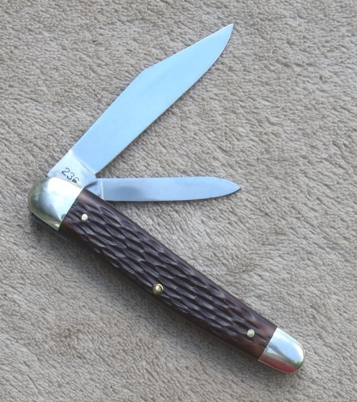

Serpentine Jack Knife. Is it a Dog Leg Jack?
Not a very common pattern. 3 5/8"
Clip blade is polished like a mirror on front side. In old documentation, Schrade described this polishing as "full crocus".
Technically that would be a "Wharncliffe Jack"...as I understand it the term Wharncliffe actually refers to the handle shape not (necessarily) the main blade shape.

Actually, crocus, a fine oxide paste, was used for mirror polishing the main blade mark side. The striated finish is called a "glaze" finish. The terms in modern usage are not intuitive, and often confused.
I hope it wasn't bretted (love the term). I have a couple other unsharpened Schrade Walden knives polished to a mirror finish on the mark side of the master blade only. The 236, and a 233, both delrin handles, and a peachseed Schrade Walden 893. All three look the same. The other side and remaining blades look like the rest of my Schrade Walden knives.

I do know about the term bretted, and certainly have obtained a few knives that were described as mint, only to find they had been cleaned. This 236 however, appears to me to be unused. I don't know enough about Schrades 1960's polishing techniques, and it's damned hard to photograph a polished blade. With my eye in person, I can't tell when the polishing took place. It is a purty knife for sure, whether it was factory crocused or post factory bretted.
What is it, a wharncliffe, dogleg, big peanut? I know its a jack knife. Any other opinions? What do you think Waynorth?

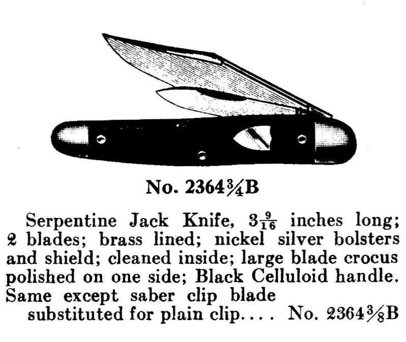

In the Schrade catalogue E and supplements reprint there is a knife within the book pattern 23643/4B, 3 9/16 long, Page 94 if you have the book, this is listed as a Serpentine Jack It's the only knife I could find that looks the same, and it does start with 236.

I think you can call it a wharcliffe jack. It has also been referred to as a serpentine sleeveboard jack. I think of a dogleg as having a wider bolster at the bottom, curving the opposite way from a saddlehorn. A peanut sort of looks like an foreshortened wharcliffe jack turned end for end.
