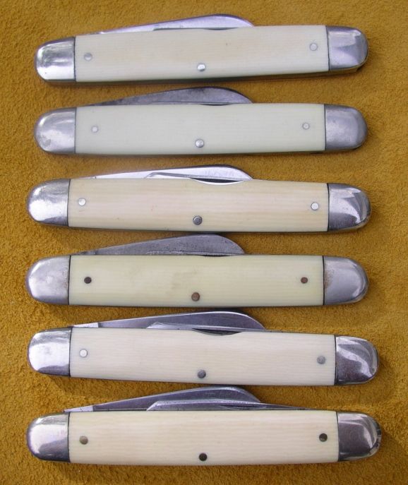

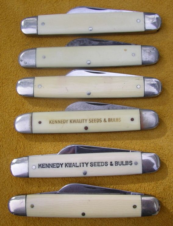

The Schrade-Walden Bud Grafting knife is a 4" Equal End Double End jack knife. One end has a Sheepfoot blade and the other end has a Spey blade. I have only seen these with imitation ivory celluloid handles. The Spey blade seats low so there is a cutout in the liner at the Spey blade nail nick.
Here are a few examples:
Of the 6 knives shown, only 4 are Schrade-Walden. Can you tell which 2 are not Schrade-Walden ? knives are in the same order in both pictures.
kj
Edit to add: will take pics with blades open in the morning & then post them here.
I'll just say 4 and 6, since those pins looks the most patina'd

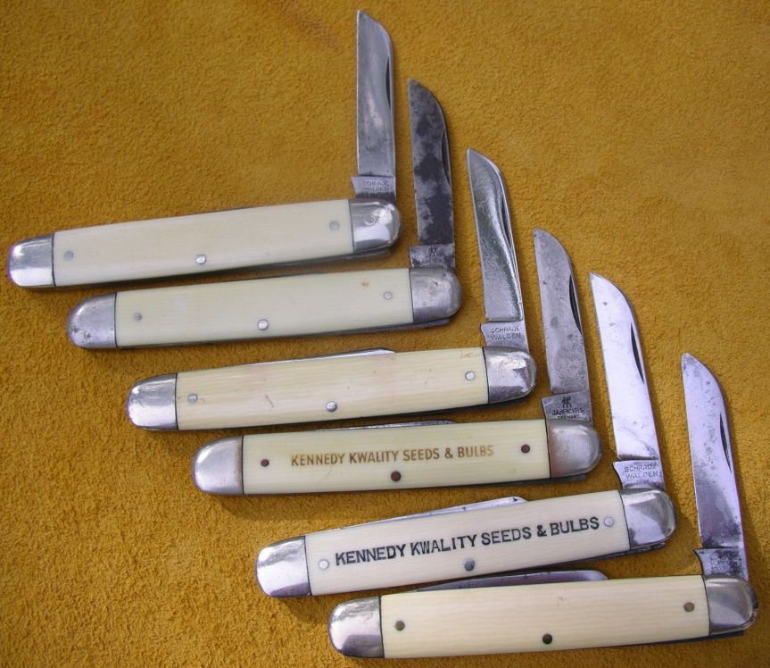

Glenn, thanks for participating. You are correct about # 4. Here is a picture with master blade open, knives in same order. You can just make out the tang markings.

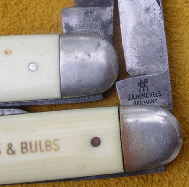

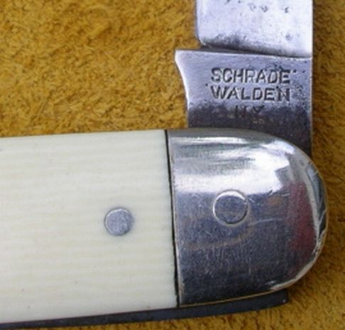

Robert, here is a close up of #'s 2 & 4:
And here is how the rest of these knives are marked:
I am sure these were all made by Schrade-Walden.
So, how did it come to be that a knife made by S-W is marked "J.A.Henckels/Germany" ?
kj
While they look identical, I believe I see a slightly different placement of handle rivets on the Henckels knives, FWIW. They are a few thousandths of an inch farther from the bolsters.
I can draw no conclusion yet, but it wouldn't be the first time a manufacturer "reverse engineered" someone else's pattern!;)
Also note, the brown spot on one of Henckels' handles, and the rust-colored haze of oxidation on the other's bolster. Those are both signs of inferior Celluloid!:eek:

KJ. while the knives look similar the tangs are quite different. Note the curve up to the kicks on the Schrades versus the straight line on the Henckels. That shape is engineered into the blanking dies. That alone would lead me to believe that the knives (or at the very least the blades) were not made at the same factory.
Eric
Eric, thank you for this help. I had not looked at the tangs but now i see the difference.
I now agree with tongueriver & waynorth that Schrade-Walden did not make these Henckels branded bud grafting knives.
