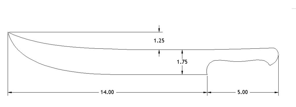

thanks guys, that is the way he spelled it infact...cimeter. Wow, very cool, there is a WHole lot of room for creativity with this design. Should be fun. AEBL is probably the economical way to go for stainless, or I bet 3V would be great for semi stainless. CTS XHP would probably be best I am thinking.
Ok here is my template so far, got enough Bellly?

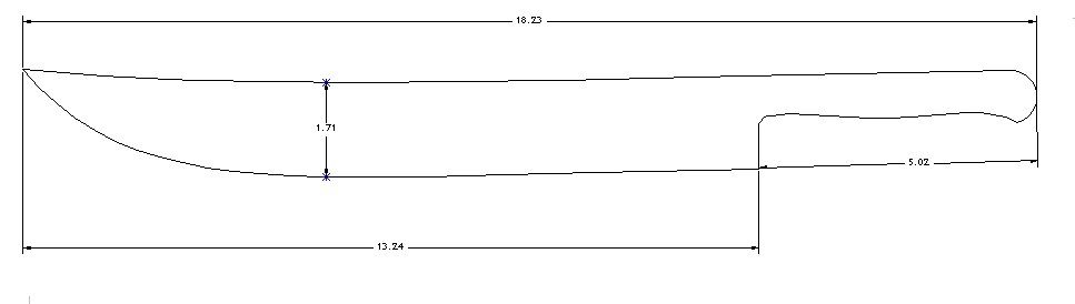

thanks bluntcut, i think i lost sight of that trying to fit it on 2" wide stock....here we are with more of an upswept tip.
Yeah much better. I like/prefer the edge profile as (heel to tip): 0-4" flat; 4 - 9" gradual curve; 9-14/tip tight curve. In a single stroke: start the cut -> slice away -> end trim.
edit: this blade profile conducive to warp at ht, especially for low Cr steels. Cts-xhp steel would be a good fit for this blade: stainless + wear resistant but still easy to sharpen and less chance of ht warp.
thats a good way to explain it.
Im definitely gonna work two of these into my next batch of stainless. Ill probably go with .130 thick aebl, distal taper starting about 5-7" from the tip to about .015 behind the edge. with a full height flat grind but convexed edge, should be ok geometry im thinking.
