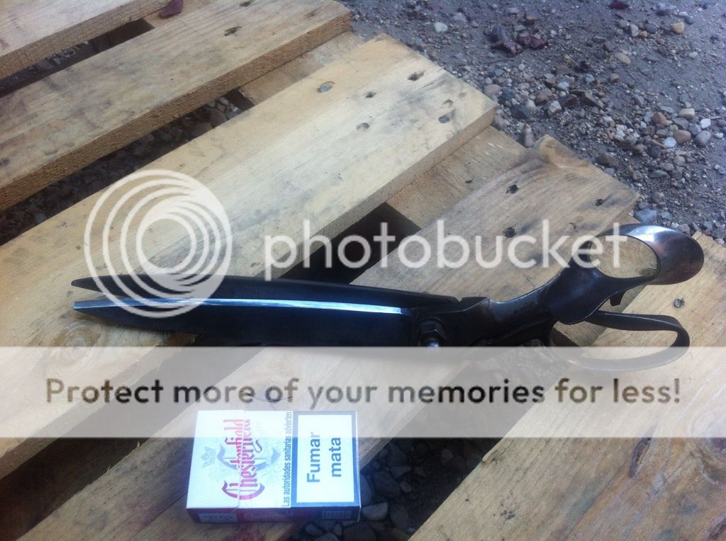

and here is the monster
It took me about 2 hours the whole process and man, my arms hurted. You can't imagine the weight of those things.

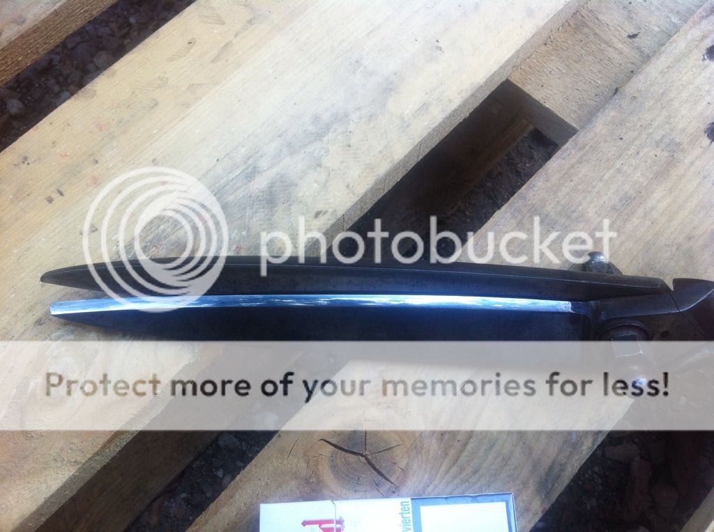

here is the bevel
as you can see It's slightly convex, so I had to incorporate a little rocking motion to every stroke.

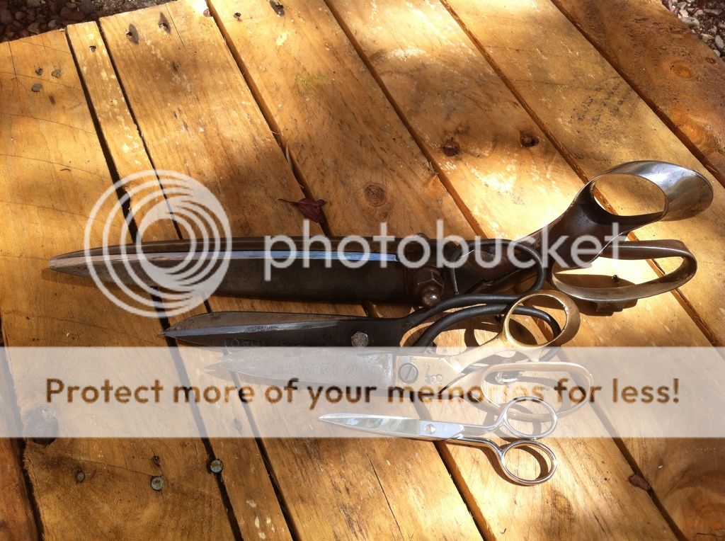

hey guys,
here is the complete set of scissors, they are curious at least:
- you saw the monster tailor shears.
- the second are handmade in Cambodia, they were badly rusted but a little sandpaper and steel wool took out the worst, some pitting remains at the tip
- the third one is from India, is not good quality, is welded with brass for the handle, but the welding is getting loose
- the last one are a simple modern pair
