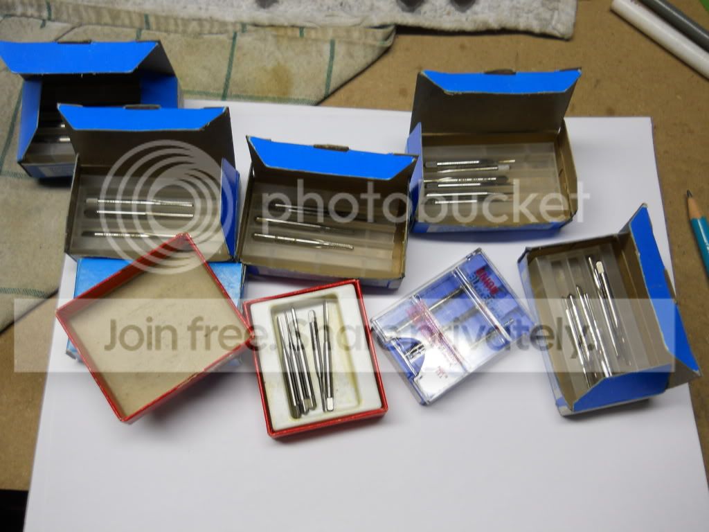

I plan on working with fixed blades for the most part, but I love and carry folders every day and naturally want to try my hand at one someday.......so when a good buddy asked if there was anything I needed for the shop I mentioned a couple things. He runs a machine shop and he said, "What about taps?" I told him that if I needed any they would have to be small ones. He wasn't sure of what he had lying around but said he'd look. He stopped by tonight and handed me this nice little pile of boxes. There's a really nice assortment from 0-40 all the way up to 10-32:thumbup:
Tools are awesome, but they're even sweeter when they are gifts! Now I'm gonna have to do something with them:D

They are larger and coarser than most folder tasks require, but I bet they will come in handy for some sort of project. You might want to tap some fixed blade tangs for handle screws. Most folder taps are 0-80,1-72,2-56, and occasionally 4-40. Get a can of Moly-Dee tapping fluid and a tapmatic and you are ready to roll.
Thanks Stacy:thumbup: I appreciate that info. Now that I think about it, I assume that is because when it comes to liner material in folders you want more threads per inch in order to get a good grip. If you are using 1/16" liner material you would only get two or three threads with a 32 or 40 screw.
