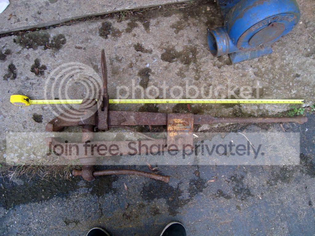

Well I picked up the post vise today, now to try and figure out who the maker was and clean it up a bit.

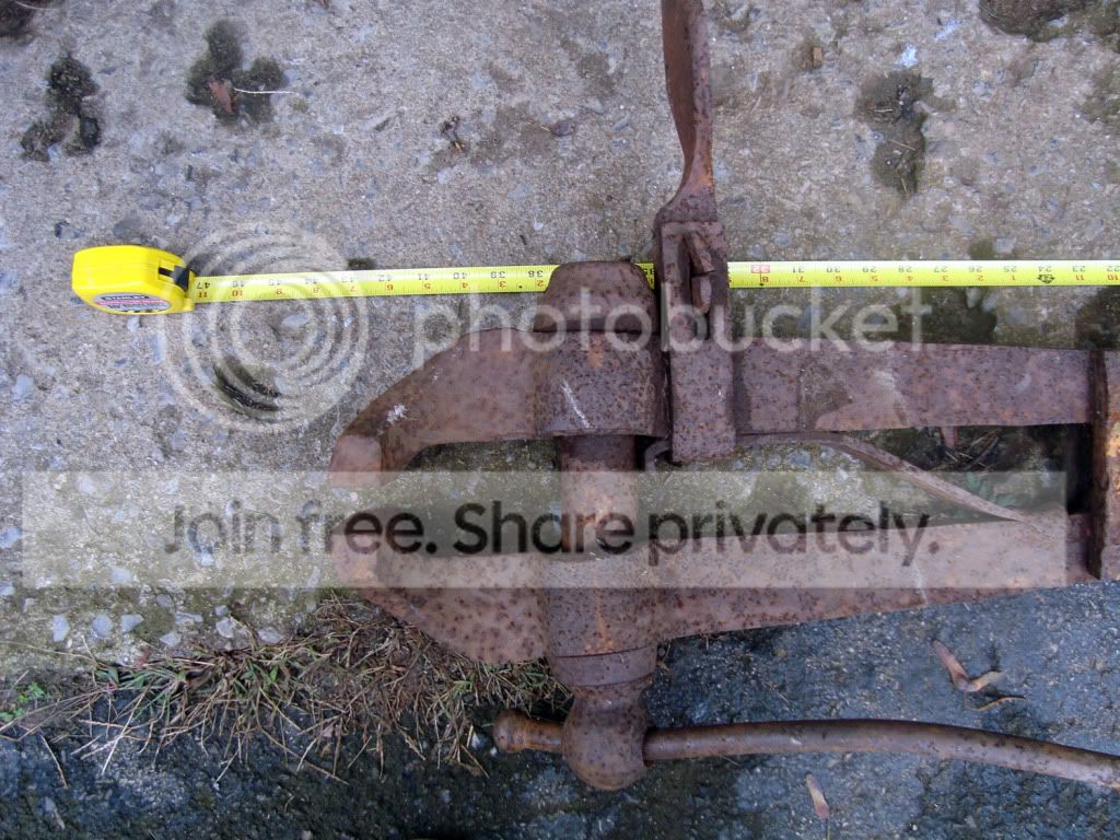

The overall length of the vise is about 45", but the stepped section at the bottom is just over an inch long. The jaws are 5 1/4" wide, not sure how far they open yet that part is a little seized. They move but its very stiff right now, I gave them a good dose of WD40 and will give it some more later today. Tomorrow I will try get the nut off and give the area a scraping with a stiff wire brush. The screw seems fine, it spins in and out with little to no resistance till it butts up against the sticky jaw.

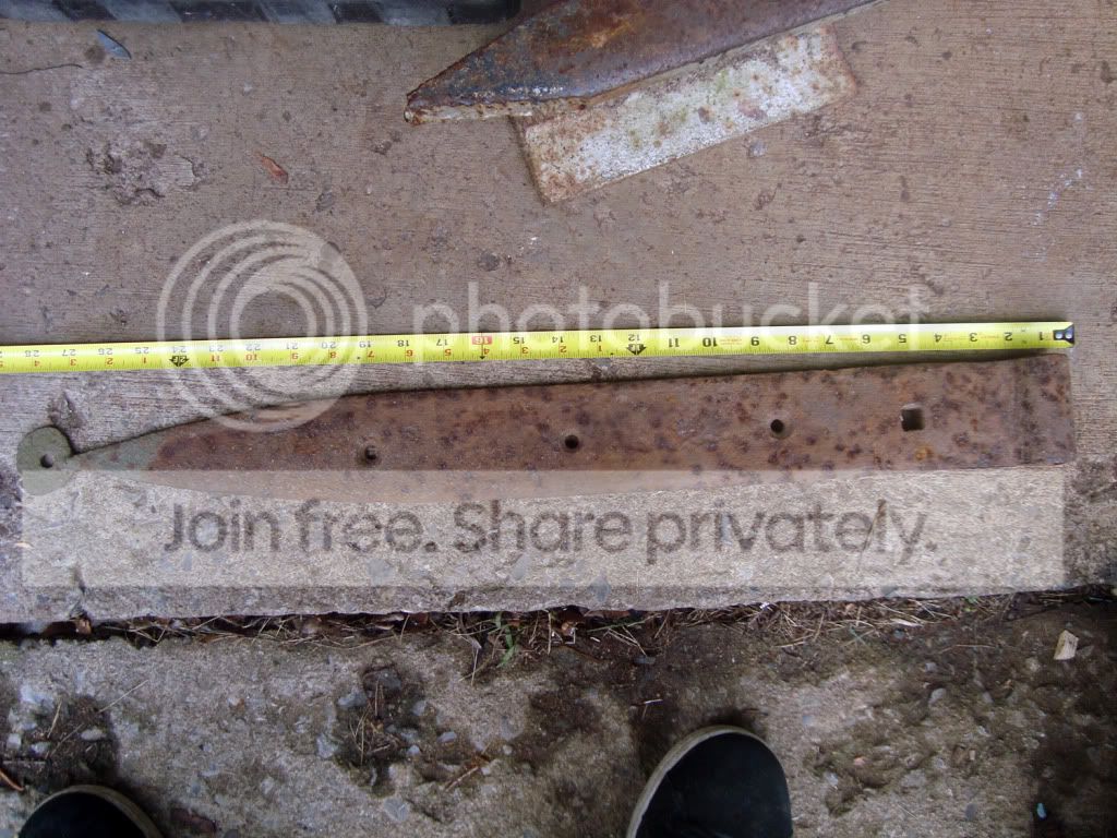

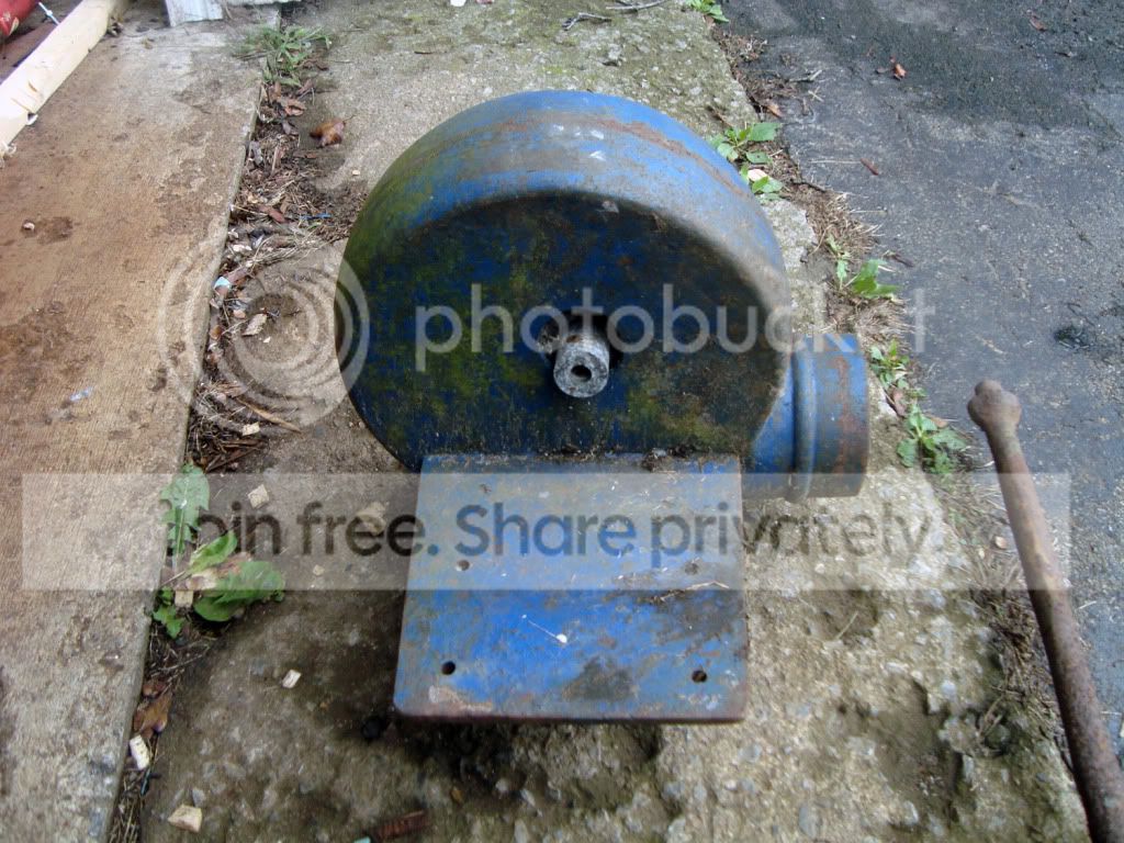

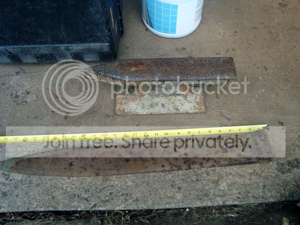

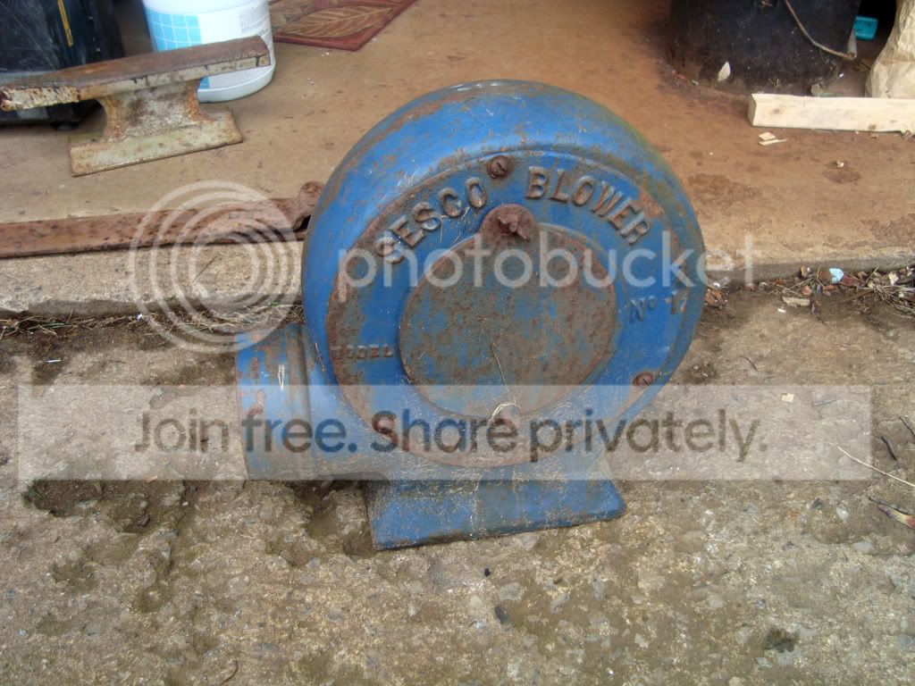

Now for the other little tidbits, The wrought iron hinge came off a barn built in the 1800s and measures out to 28" of usable steel, the blower is huge, with an outlet measuring 4". It even has a base to mount the motor to, so a quick cleaning and some paint and its ready to have a motor installed. The RR anvil is tiny, maybe 15#, but I figure if I make a steel mount for the vise with some I-beams I can mount it to that and it will do the job till I find a real anvil.

Cool man. That blower looks good for a forge. And a 5-1/4" post vice is a good medium size. The first one I got was a 4", there are a LOT of them out there. My first anvil was a piece of track not unlike yours.

You can almost triple the mass and weight of the RxR anvil by welding or bolting some sections of steel to both sides of the "web" or waist section. Couple of cut to shape and ground to fit drops from the local steel fabricator or scrap yard will do the trick. It's not so much the size of the surface or face of the anvil as it is the mass under the hammer. Pretty easy and cheap way to bring RxR track up several notches. Will help with noise and vibration as well.
