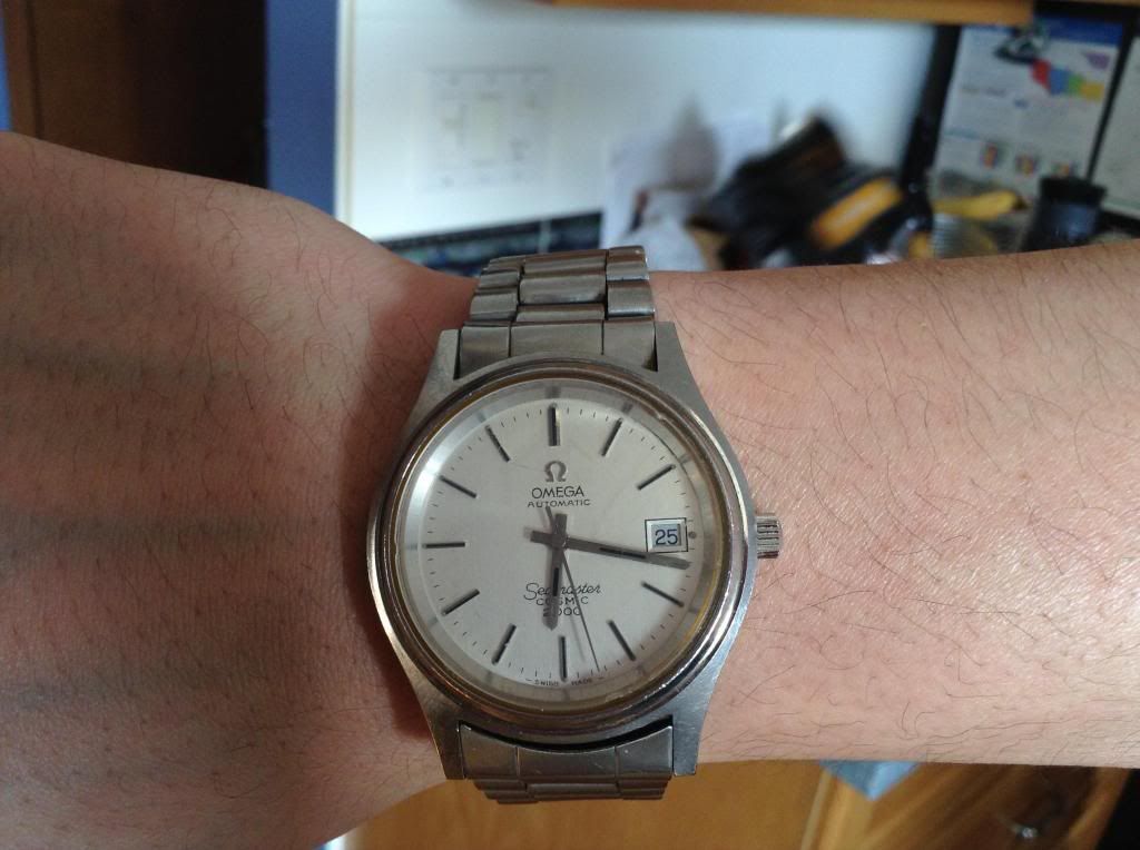

I got it. It gains about 10 minutes per hour so I'm taking it to my watch guy to have it regulated. That's no biggie and shouldn't cost much.
Gaining 10 minutes per hour implies that it's magnetized. It shouldn't cost much, if anything, to get it demagnetized.
Sweet, that makes a lot of sense. My watch guy is Rolex trained so it will be a quick buck for him
Good looking watches you got there Matt. Hope she digs the watch and everything works out for you.
My watch guy said the fix would be $90. Worth it in my opinion.
For $90 make sure he's cleaning, servicing, and lubing it and not just degaussing the mainspring and regulating the watch. It is simple and quick to just degauss and regulate a watch.
Never put a mechanical the watch on top of a stereo speaker, refrigerator, or anywhere else there is a magnetic field.
Yes, its getting serviced.
