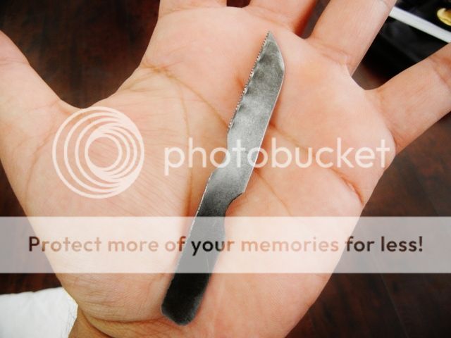

Repurposing knives is what I spent several years doing prior to buying some real knife making equipment. I've thrown away most of them, but I still have a couple little neck knives I've made...
The top one here is my favorite:

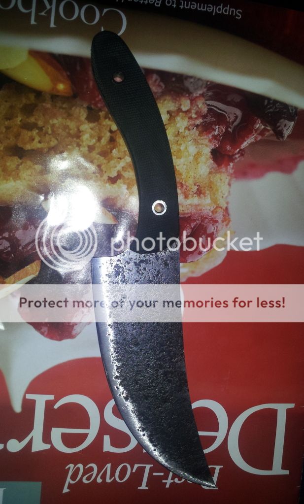

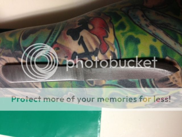

That's really cool. My grandpa got me into knives as a kid and I would always fool around in the back of his shop pounding big nails into little knives and making makeshift handles for them. Just recently I started going to the local flea markets and buying up old files to make into knives. The only thing ive been contemplating is if I need to re-heat treat them once im done or before i finish it. I have one I started today that I still need to drill some holes and decide what im going to use for handles.
I find that re-heat treating depends on the thickness and intended use. Some knives (small utility blades) are fine to be left fully hardened like a file, But anything else will need to be annealed some. I like 1 hr at 425 in the kitchen oven.
