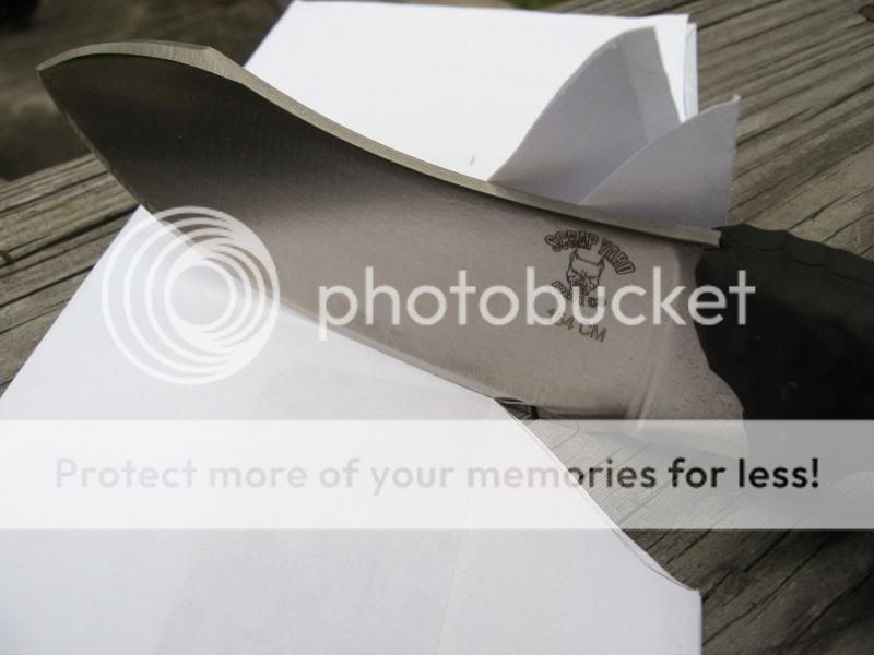

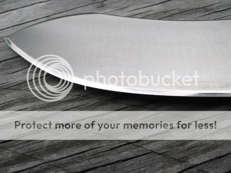

I just did the edge. Started with waay-too-fine sandpaper on a mousepad. After an hour and getting nowhere, I went to the belt sander. Took about 20 minutes, but it's near impossible for this fat-fingered-fellow to do it right AND not grind into the handle just a bit. Just because of the design.
No pix at work. I'll try and take some. It's possible, but not the easiest blade to do it on.
The 154CM steel is a bit hard to work for me. It heats up fast on the belt sander. It takes and holds a wicked edge, though. Here is my Scrap Muk:
Thanks for the info Dennis & Horn Dog. Thanks for the pix.
