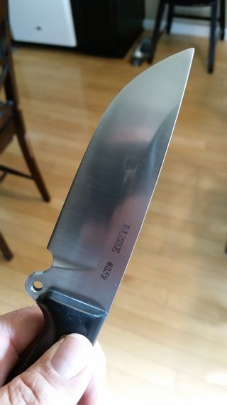

Hello all. I am seeking some wisdom from you hogs. What do you guys use to get scratches out of your sexy satin? I don't mind them and will be adding plenty more but just want to doll a blade up for a photo shoot. For you guys of course. ;)
Plain white toothpaste works pretty well. Or buffing compound from a spraypaint supplies shop works well too.
I think satin looks best when it's beat on personally. The first few scratches look a little out of place, but with regular use it will look better and better.
I work them up and down the bloodied rib cages of my vanquished foes..... ;) Being a Viking that should appeal to you as well mate !!!
I have some fine metal polish at home (not sure of the brand now) that does a nice job on small scratches and such :)
Sweet! Ribcages were my initial thought had to make sure. Thanks for the replies guys I have a few of the suggestions on hand I'll leave which ones up to your imagination. Zombie I couldn't agree more I just want to shine it up one time for some nice pics and then it will get plenty more scratches. Plus I do want to show them off. New in the Busse addiction but pretty pleased with my collection so far and had some beauties delivered today.
Beat them against the major bones of your enemies until all the scratches blend together. Or Nevr-Dull wadding polish if you're pressed for time/short on ribcages, spines, femurs, and pelvises (pelvii?).
I used 340 grit wet sand paper and WD40 to doll up a used satin blade that I bought. It came out pretty nice. Hardest part it keeping the strokes in perfect alignment with the factory sanding marks.

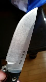

How bad are the scratches?:
Outside
Inside
Same scratches. :)
