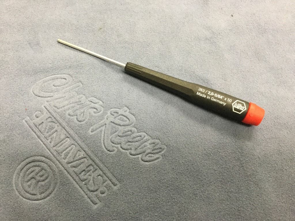

I know it's probably been discussed before, but does anyone know the size of the screws used on Sebenzas?
6-32 looks like a good fit- Screws in well.

You can add this also as 5/64" will cover all your frame screws ( with the exception of pivot screws on Sebenza 25, inkosi, Ti-Lock ). Many like me prefer something like this as compared to a small hex wrench. Well worth the $5-7$ it costs.

To anyone or all that own the Wiha wrench: Does it just fit better than the ones that come with the knife? I keep putting off purchasing the Wiha. I really need one.
I found that a 2mm(I think) fits completely in the head versus the 6/32 that has some movement in the older screws. The newer ones have been reporting in as being almost too close for the included key to fit. When I get home, I'll open my tool box and see what size it was, but I'm pretty positive it was a 2mm key.
2mm is pretty tight, but works..6/32 reduces down to 3/16,..much too big..You must mean 5/64
Any quality hex wrench should work well..Fit is a problem with off brands sometimes.

I already gave the OP the correct information on the screw size- It's a 6-32
