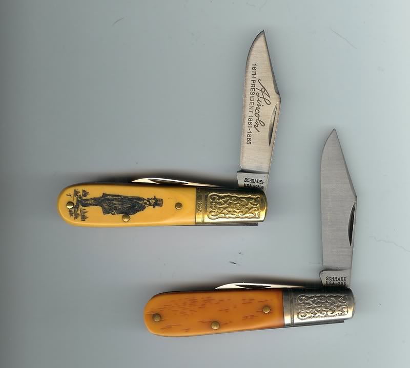

Thanks Michael. I'm doing my best to try and assemble every OT and UH folder. I find there are a lot of scrimshaws out there and they have different tang stamps. It can get quite confusing for a newb like myself. Another newbie question: Are the scrims considered different knives altogether or are they considered variants (i.e., I have several 505sc's that are just like the 8OT's) of the OTs and UH's? As a collector trying to compile as many different Schrade folders as I can, I just take it as being different knives altogether but other than the handle, they are the same (obviously, a lot of the UH and OTs are that way but have different shields). And for example, take a look at the two barlows below. They are the same exact knife for all intents and purposes but the difference being the handle. One is tangstamped a 206 and the other a SC506. Is that due to the year of production or is there a different reasoning altogether? Additionally, will there ever be a week-long class for Schrade collecting? I sure could use one :o
