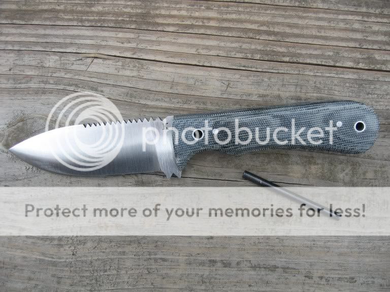

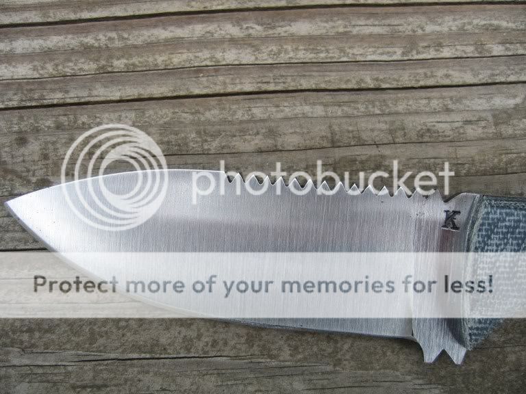

My design involved a knife with a 4 blade and a 4 1/2 handle. I also wanted to have a backup single row saw tooth back in case it was needed. I wanted a very sharp point on this knife and John did his usual EXTREME sharp blade on his knife. Damn sharp!
Notice under the makers stamp I also had John put an integral fire steel striker. I never liked the idea of trying to use the "back" of the blade or definitely not the blade itself.

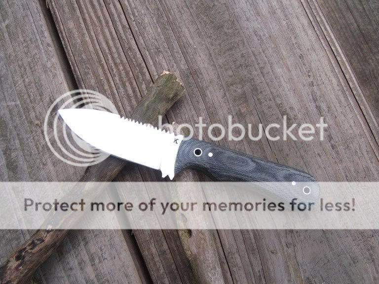

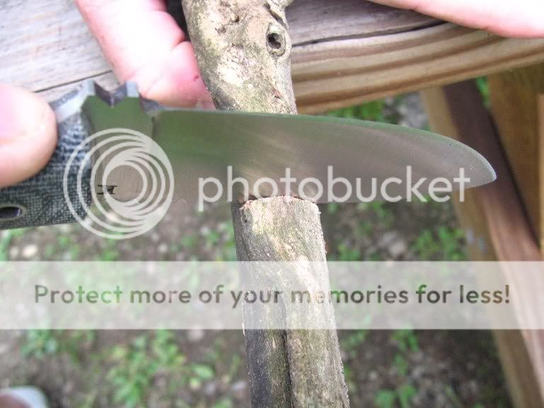

The single row saw teeth zipped right through wood I grabbed from my back yard as a test today. Think melted butter.

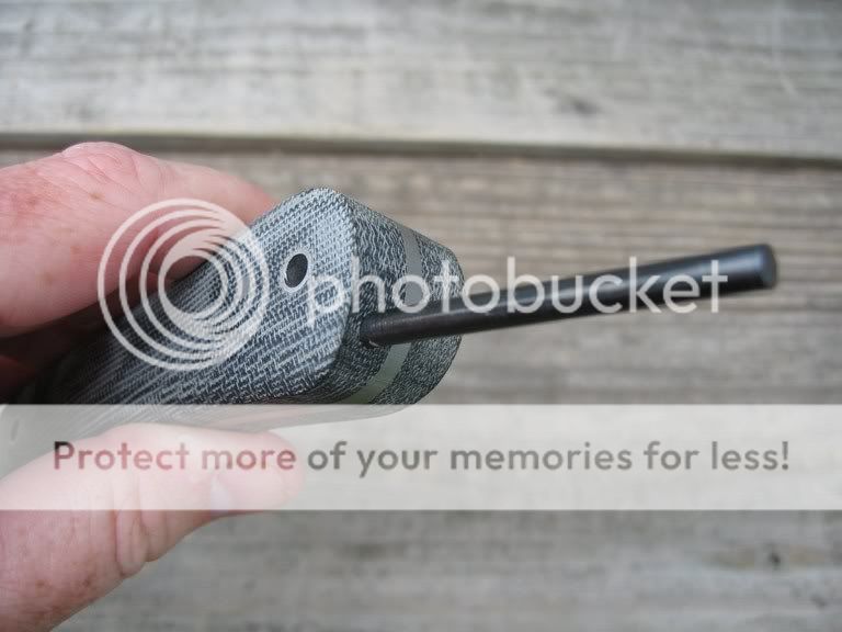

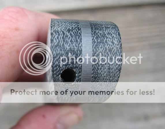

I also had John drill a 3/16 x 2.5 hole in the handle (think Swiss Army Knife toothpick) for a fire steel to be slipped in.

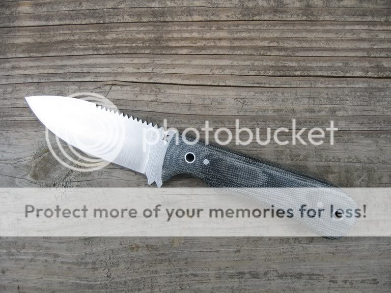

I also wanted a double lanyard layout in case the knife had to be lashed to a stick for a spear or similar setup.

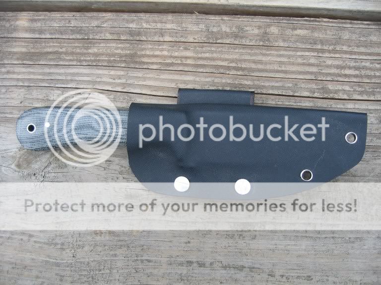

Another thing I asked for was a kydex sheath that could be utilized horizontal or vertical carry based on the equipment I had at any given moment.
The handles are strong black canvas micarta and the knife is solid 01 steel that is heat treated to a level of strength that is impressive. It fits your hand perfectly.
