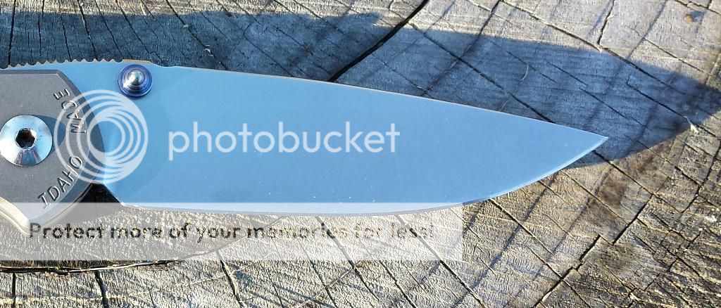

Hello...I have a few CRK Sebs and am a newer EP user. I've had it maybe 4 months and probably done 20 knives max. I have gotten better as I go but the 25 is a lot different than my 21s and I had a few questions...
The tapering at the tip seems to leave a lot more steel on the 25 than the 21. So much that I can get the knife itself quite sharp, but the tip area is always a little duller. The burr is much slower to form on the 25 than a 21, or it at least seems that way. I think the mechanics are correct...and the Sharpie test indicates it's in the perfect location to make contact with the entire edge. And most of the knife I think is easier to sharpen than the 21. But this tip area is annoying me as I cannot figure it out. I've used riser blocks and just sharpening that area at a higher angle...the first doesn't work great and the latter is quite a pain. I spend more time on that area to form a healthy burr, and then remove it. And my strokes are in the fashion appropriate for finishing to a razor edge.
Also, for those using the EP, how many passes do you generally take with each stone type for general maintenance sharpening?
What angle are you using? (around 18-20 a side I presume?)
What am I doing wrong or what should I try? Having only sharpened a Seb 25 twice, I am guessing part of it is acclimating to skill? This is among the thicker of knives I own...

Not sure what's going on with your tip area if you say you're forming and removing a burr on both sides. Are you reaching all the way to the tip? I guess you could form a burr without reaching the apex, but if you've been at it for a while that doesn't seem likely. Take a look at it under magnification.

I just lay my Sebenza 25 on the table flat and adjust the angle. I use chosera stones so they cut a lot faster I don't count just keep the bevel even and raise a burr.
