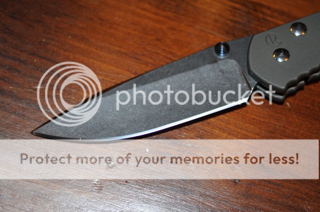

According to CRK we should be able to touch up the Sebenza on the Sharpmaker. However, my new 21 and my regular could not be touched up. The factory angle was too great and I was not able to reach the edge at the 40 setting.(I would prefer to touch up the edge at the 30 setting). The sharpie trick showed that the bevel was being touched up and not the edge.
As some of you already know, I have an edge pro and thinned out my small regular sebenza(Was the 2nd knife to ever go on the Edge pro :foot
. I had the edge pro set on the red setting (15 per side) and just went to town......My end results allowed me to touch up the edge on the 30 setting of the sharpmaker with ease!
Raw results.
:barf:
Then It was cleaned up and finished off.
I don't really want to thin out my new small 21 in the same fasion. However, I want to be able to touch up the edge on the sharpmaker. My only issue is when it comes close to the tip, I have much metal to remove and I don't want to have the same results as the regular sebenza. If you take a closer look, you can notice that there is a lot of metal removed from the tip. I remember reading some of us had the same issue.
For those that use the Edge Pro / Sharpmaker method, how did you reprofile your edge and were you able to reprofile and still have your tip stay pretty much factory thickness? If so, what were your settings?
I was _ close to going full blown at it again with the Edge Pro and the 21....took the polishing tapes to it to see if the 15/18/21 settings would work, but with all settings, I would have to remove lots of metal from the tip. (Sharpie trick works wonders here).
I am definately not happy with the factory edge but I am not wanting to go at it again blindly. :thumbup:
