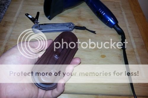

As you all know most of the inlay Sebenzas come with a leather sheath. Heres what I did to one of mine with some water and a blunt tool... Once dried its just like any other leather friction sheath with great retention.

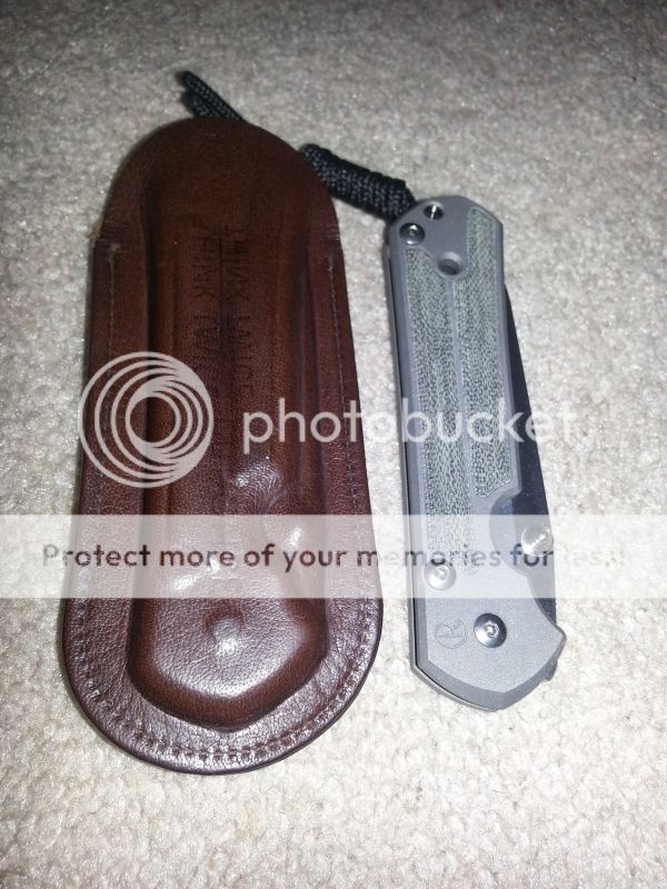

So I did it again...
Makes sense, since they can float around in a loose sheath. That second one looks awesome, fitting a 25 like that. :thumbsup:
Thank you. I was able to form the 25 a little better than whats in the picture but honestly I just the like the way they look versus what they'll actually do for me. The downside is I had to buy two new sleeves to replace the ones I borrowed from my other Sebenzas since neither of the knives above came with them. ;)

I kept it really simple.
First, wrap the knife in a little bit of plastic wrap, just to keep the moisture out. Stick it tight into the sheath and try to center it. I centered the inlay knife using the Think Twice branding on the sleeve and the groove between the inlays.
Once you have it in position, just keep wetting it with your hand. I used hot tap water right from the sink. Forming the leather with my hands it dried fairly quickly so I just keep wetting and forming. The wetter the leather gets, you'll see it's saturation with a deep darkening... especially in grooves of what has already started taken form. (as seen in one of my pics) That's when it gets really easy to form the final shape and the leather really takes on all the details of the knife. You can use anything blunt but I found that the handle on a small nail clipper worked beautifully. Pressing it against any hard edge of the handle and blade, thumbstuds and clips... whatever. You can actually see the lock bar now. I also used a blow dryer just to shrink the leather around the knife which doesn't shrink it much but it tightens it up nicely.
Thats it. I will say that I went back and forth forming and blow drying 3 or 4 times. The more you do it, the better it gets basically. Hope that helps and sorry about the long read.
