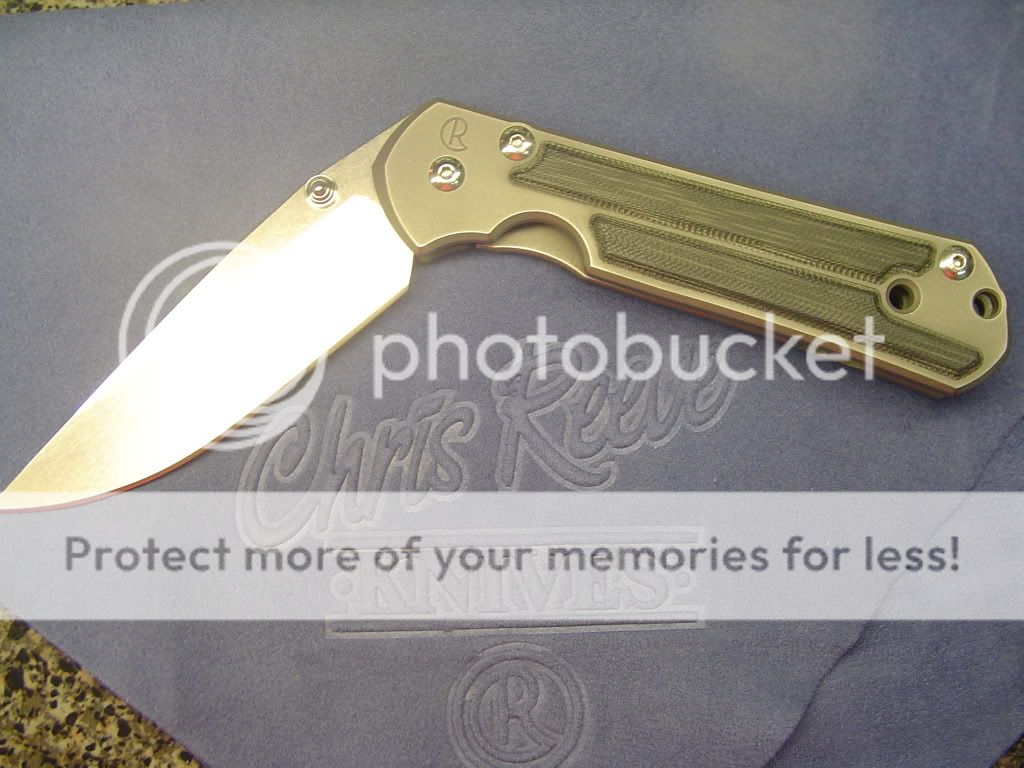

I'm having trouble with a new(to me) used 21 micarta(2010) pivot.
I've always thought you could really tighten the pivot up, and it wouldn't effect the action/ smoothness? I've tightened it pretty snug, and then the blade doesn't move. It wasn't until i backed off it a tad , that it was smooth again. I found a sweet spot that i liked, and noticed a tiny bit of play. I retightened it some more, and have found that it becomes loose after a while?
I've had a few other 21's, and i hadn't really had this problem? Trying to find some more experienced knowledge from my fellow CRK buddies:)

Here's a pic for the thread: I love Micarta inlays...
