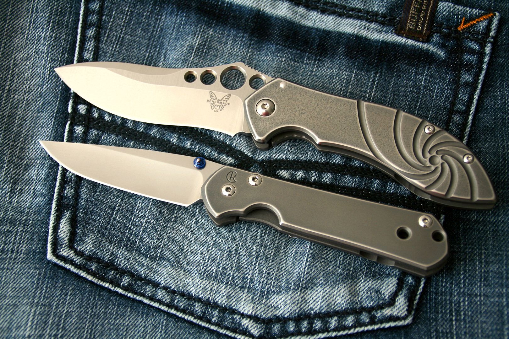

I'm new to the forum and this is my 1st post. I have been reading this forum for awhile and it always has the best discussions. I have progressed with my collection over the years and will be buying my 1st Sebenza shortly. I read somewhere and saw photos of a Sebenza that had the titanium handles scuffed down with scotch brite and it looked great. Has anyone done this and if so what color/grade of scotch brite did you use. Thanks
Hello there, friend, and welcome to the Forum. You may have been talking about the pix of these two that I posted recently:

The handles on the Sebenzas are not treated or coated. They scratch very readily. If you send the handles to Maprik or some other anodizor, the resultant finish will be much more resistant to abrasion.

Anodizing looks good, and Maprik is very good, but be careful about "sanding" your scales. IF YOU ROUND off the edges, then Chris Reeve will no longer tune up or work on your knife. The warranty is gone if you round the edges. So perhaps call 'em in Idaho, and talk to the girls that answer (two wonderful ladies) and see what they say...before you do anything.

I have re-finished three Sebs this way, and I have never had even a slight problem (keep in mind that I only re-finish the outside of the scales - never the inside). And I have never needed the warranty either on any of the 14 Chris Reeve knives I have owned over the years. So, it's all good here!
I tried the scotchbrite finish and did not like it. I took mine apart, into the blast cabinet with some 80 grit glass beads and done. Smooth finish, doesn't show wear like the original.
I tape up the detent ball, but other than that I blast the entire surface. I did this to my Micarta model, and it did not damage the micarta at all.
