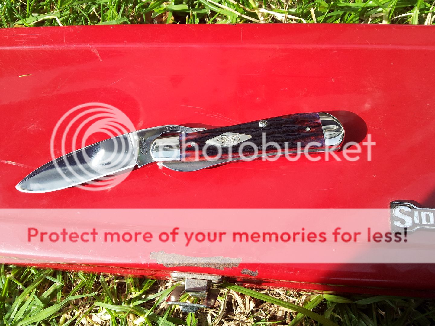

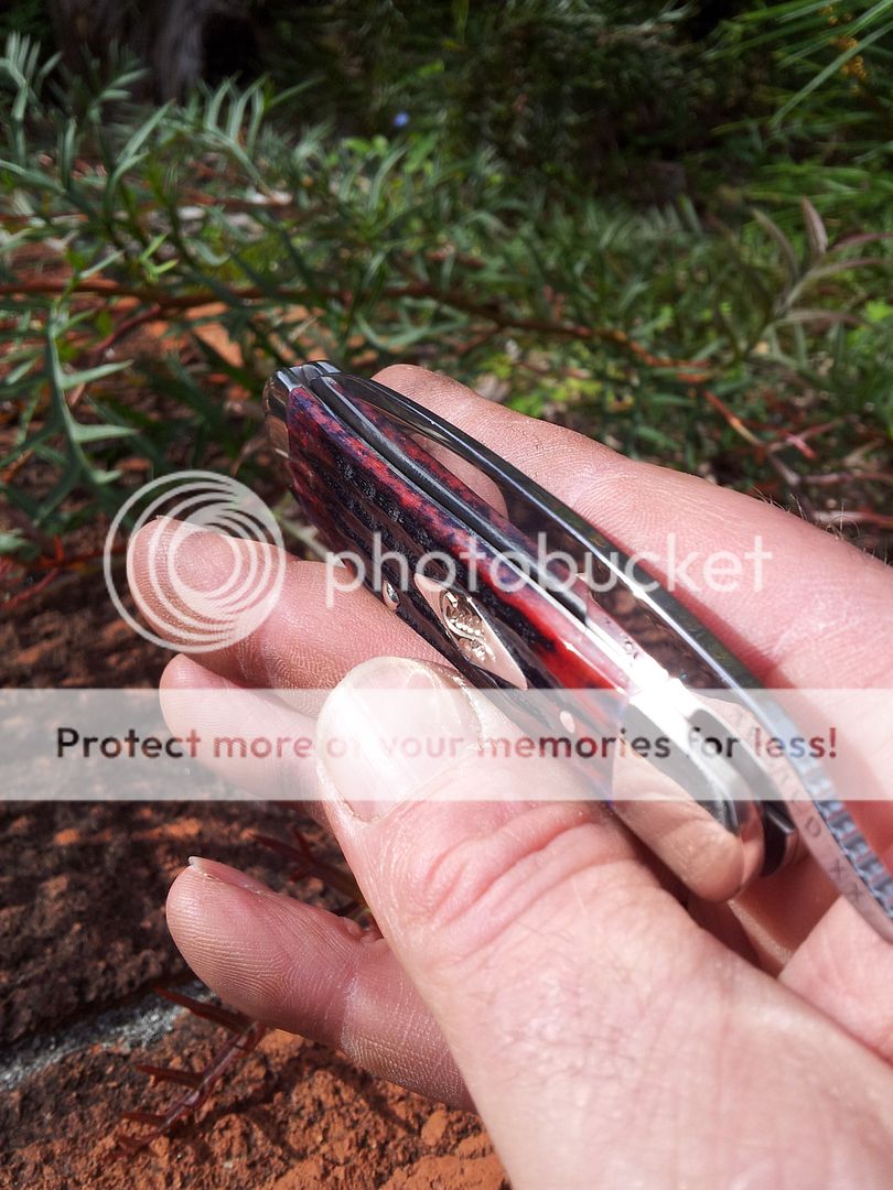

`Right here it is -just turned up today.:) Crimson second cut bone. Its definitely to do with the jigging pattern. The bone is perfect. I was expecting the crimson to be a bit brighter but this is a classy looking little knife. I especially like the chunky little drop point blade.
They did a good job on the dye with that one.

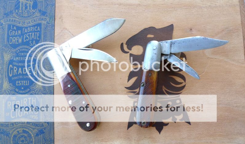

Bearing that in mind, recall the old knives such as Barlows that were a working man's knives that were advertised in the old ads as having "second cut" bone on them. I have a 30's vintage Barlow Keen Kutter that has second cut bone scales and they didn't even buff out the saw blade marks. Likewise, the same effect was tried with the Dan Burke Barlow I have where they left the saw marks on them as well. You cannot see them due to the poor photos, but in person you can EASILY se the marrow holes on the DB's scales. I lightened these up a lot so you could see (hopefully!) the saw blade marks left on the scales.

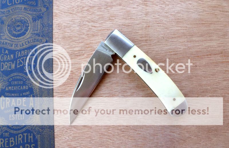

First cut bone can be nearly flawless. Check out this AGR Wharncliff with smooth bone handles. You can see that it is just now starting to amber a bit after about year or two of carrying from sweat, coins and a bit of age. But when I got it, the bone was so perfect I didn't like it as I thought it was plastic!
