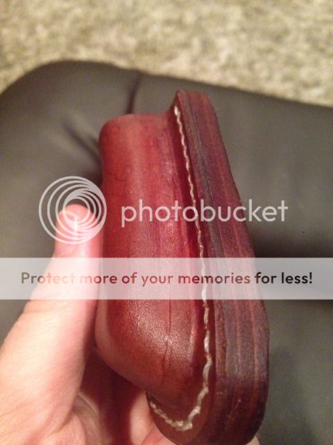

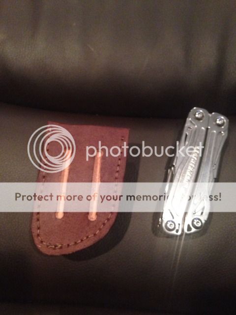

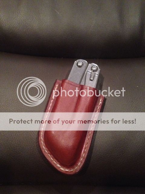

So I finally finished my second project, turned out pretty good i think.
The stitching isn't great, which I expected.
Couple questions:
How do you guys get a uniform line around the sheath for stitching? I was thinking of sanding the outside edge to final dimensions then use a stitch groover referencing the outside edge?
I used a stitch wheel then an awl but couldn't get through all three layers so drilled them but this made the stitches uneven in spots, Are prongs the way to go?
Thanks to all the inspiration here on the site.
All and all nice piece. Regarding your question, yes on the groover. The prongs are not IMHO without their own unique challenges. On very thick leather for me at least they tend to get stuck in the leather if they do go all the way through. Also I've had occasions where it pushed the welt out of the way instead of going through. They do make nice hole to sew through and if all goes well make a nice stitch.
I have, prior to gluing left the welt out and pronged the front and back at same time. Then glue up with welt in place and use an awl to pierce the welt for sewing.
Make sense?? I have read several folks here use a stitch wheel for spacing and a sewing needle instead of a drill bit in a drill press to make the holes but I have yet to try.
That's very good forming :thumbup:
Leatherman tools tend to be quite thick , and that makes the forming more difficult .
I personally prefer a loop of some kind to attach it to your belt instead of the slots cut in the leather .
