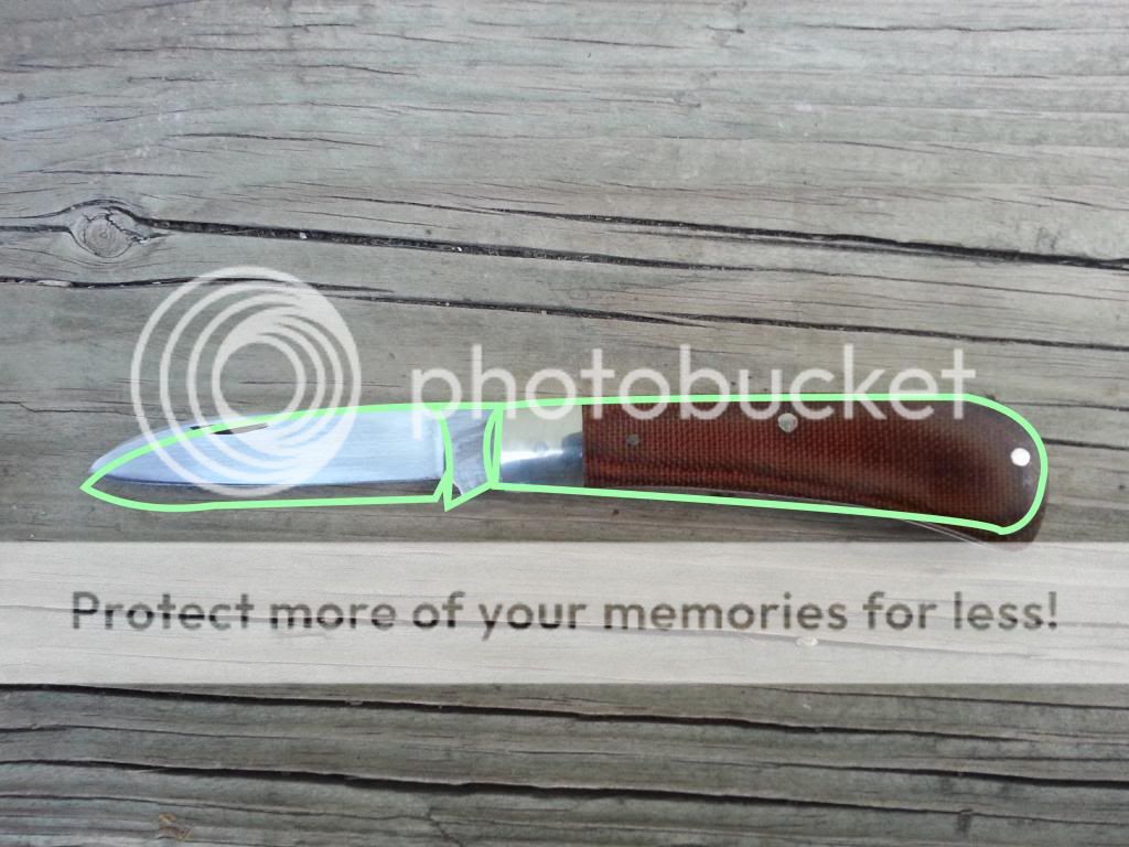

Finished up my second slipjoint last night. I'm excited to have a knife I can be proud to carry, instead of my first attempt, which was an abomination of a knife.
Specs:
Steel: 3/32" A2 @ 61 Rc
Heat Treat by Peter's
Covers: Brown Canvas Micarta
Pins/Liners/Bolsters: Nickel Silver
OAL Open: 6.4"
OAL Closed: 3.5"
Bolster to Tip: 2.8"
Plunge to Tip: 2.4"
Thickness: .40"
Hand rubbed 320 grit finishing the blade, 800 inside the liners and buffed on the covers. I need to go back over the handle again though, it looks like.
The edge is .0015" right above the sharpened bevel. I ran it about ten strokes on each side on a very old 400-600 grit silicon carbide stone, then stropped. Very easy to sharpen with that thin edge, even though with its high Rc.
All numbers are rounded to the tenth, that's why they don't quite add up exactly.
I am pretty upset, I think I grabbed a piece of stainless rod for the pins instead of nickel silver. You can see the pivot looks like a different metal entirely. Live and learn. I'll make sure I never do that again!
Bear with me, there's going to be a bunch of pictures. I couldn't get my makeshift photo booth to work, so like McDonalds, you get a bunch of mediocre instead of a little great. :)
The scuff marks are where I messed up and laid it too flat on the very first stroke sharpening it, not leftover grinding marks. I am not going back and fixing it, because its going to get a lot more dinged up before this is all over. I would never send one out like that though.

Critiques, comments, criticisms welcome and encouraged. Tear it apart, I want the next one to be better. I already have a long list I want to fix on number 3.

the grind on the spine isnt even on both sides and the pin near the end of the handle looks like its about to fall through the micarta, maybe usea smaller one?

If I'm not critical, I won't get better.
The grind is off for sure. I am piss poor grinding with the handle end pointing left. Partially me, a lot my platen. Fixing that as we speak.
The handle pin is a result of being not good at pinning. It is a 3/32" pin, but I had too much sticking up when I started pinning. It will be better the next time. It is actually where it should be per the pattern, but my poor pinning job makes it look like it does.
Look up Don Robinson's book "Slipjoints My Way." It's on Amazon. It is a great book and it literally shows exactly step by step how to build a knife and even provides a pattern. I'm not affiliated in any way, just love the book. It's worth every penny.

My "cruel" critique is that you should have rejected the blade as soon as you:
-lost too much of the edge to keep it looking full
-made the nail nick
By keeping it you couldn't NOT end up with a blade that looks "tired" (to borrow a Japanese sword term). If you had a blade that was fuller and had a good nail nick than even with uneven grinds this knife would look so much better. So my critique would be to have the patience to start over again when necessary- the fitment skills will come with time but it's the intolerance of mediocrity that makes for great knifemakers.
By the way, I'm curious how you envisioned the blade shape when you started the project- can you draw it out?

It's not crap. It looks better than my 2nd slip joint, but not quite a good as my 4th. So each one should get better.
As said, your blade doesn't look full, my guess is you had to adjust it as you were grinding.
Good thing about making a bunch of small fixed blades, is you get a lot of practice grinding bevels and finishing blades. You may not have much use for fixed blades, so make parring knives for the kitchen. Keep a couple and give a bunch away.
You need to do something to keep the sides of the tang from rubbing the inside of the liners. I use .005" bronze washers, but most guys relief mill the inside of the liners.
Keep everything flat, flat, flat and all holes 90 degs. Before pinned together, it should be assembled and held together with clamps. At this point it should work right and have no gaps. Hammering it together wont make it any better, but can make it worse.
Your weak cam action at the half way point, just means you need more roundness on the end of the tang, more hump.

I lost about .060-.080" off the edge when I was grinding it. Platen issues that I will have resolved before the next one.
I would have started over bit I was out of steel! Haha. Also, if I started over every single time I made a mistake, I would never have made this thing. As it is, I know I can get the action right at least. Or kind of right.
The whole thing is an exercise in not quitting and chucking the whole dang project. I've never had so many ups and down with projects than these stupid knives. Fun though. :)
I'm going to try using a dremel or similar on the next one. Maybe an end mill in the drill press, but that seems dangerous.
I'mng to have my blade and spring flat ground after hardening next time. Also, I lapped the liner/cover combos flat enough to feel them stick to the counter, but then they still weren't flat compared to the blade and spring. I think my spring and blade weren't flat enough.
how much is right? About 10% more on the cam than the other two dimensions? I am going to work on my cam tangs on the next one.

Brian, Don knows his stuff and has given some great advise. FLAT, is one of the most important words he used. If you can get a granite block that is made flat that will help. I use mine still all the time. The one tool that took my folders to a new level was when I bought a surface grinder. You want to talk about flat, holy cow. Before that I used a disk and my granite. They still turned out pretty good.j
My first two folders I did not have a mill, so what I did was etch relieve the liners. You can use fingernail polish and block out the parts you don't want etched then dip the liner in some ferric chloride solution for a few hours and you will have relieved liners. I would not put an end mill in a drill press. I run mine mill pretty slow to relieve the liners and I think you would have some problems.
For my cam ends I basically take a tang that has a half stop then add a radius on the end. Then you shouldn't have trouble with it being weak or lazy. Sometimes you have to take some off because it's too much but that's easier than adding more on.
