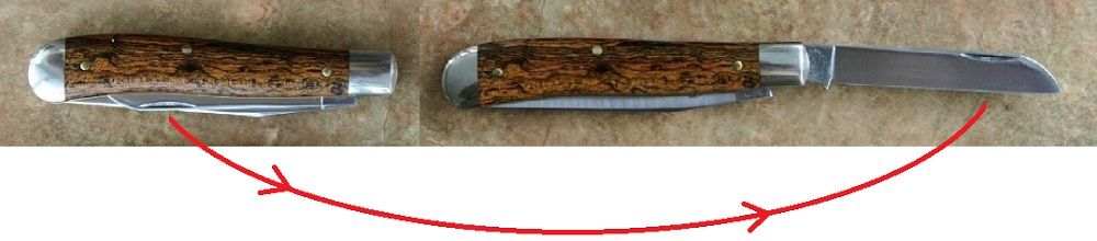

When I open a traditional with mark side nick, I hold it in my left hand, spine up, and open the blade to the right with my right hand. If the secondary is behind, with the nick pile side, I rotate the spine down to expose the nick, and still open it to the right with my right hand. I don't like to use my left hand to open blades.
