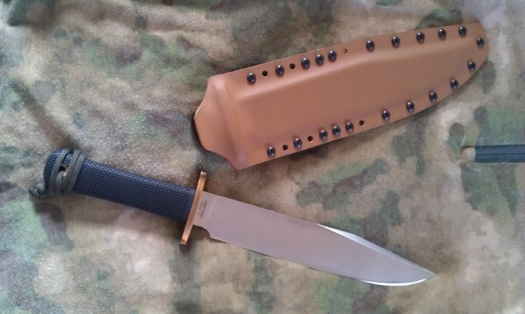

I seen his video, and there is something in my secure-ex sheath scratching my trail master. Starting to tick me off to the point of dropping $70 on a custom kydex sheath. The secure-ex is badly flawed.
Guess I was pretty aggravated after posting in this thread, I plopped down $70 simolians for a kydex job later that evening (yesterday). I just can't justify having a $145 blade living in a $2 sheath, my girlfriend made a good analogy, like putting dirty underwear on a clean a**.

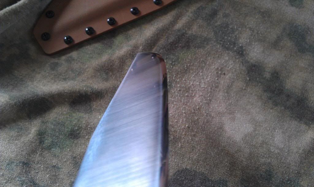

New sheath and working on a good convex edge.
