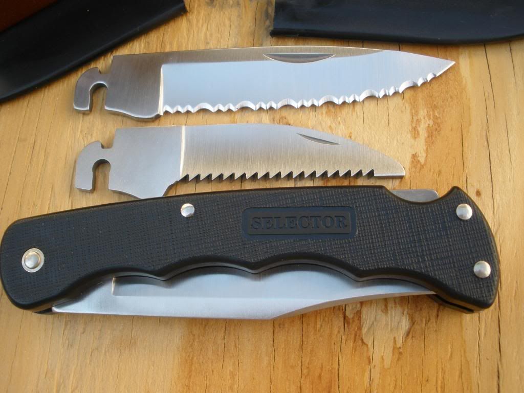

Here are some some pictures of blades. I need the Drop Point on the knife in the top picture for a project knife I would like to do.

Thanks guys, the one I was looking at had the gutting and sawblade blades and neither were very interesting. Great info-thanks again.:thumbup:
Sithus, No its the prunning blade and was offered in both the plain edge and serrated . They are hard to come by as well as the skinner . I can't believe you picked up selector blades for a buck . What a deal . There were 10 different blades offered for the Selector and 3 handles(4 if you count the two blade handle) . It was introduced in 1988 and by 94 it was on its was out . DM
