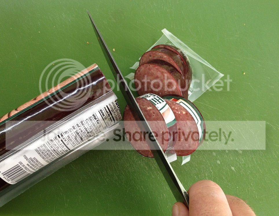

Here's how thin the 5 is. The steel is only .188 at the handle. It's thinned out distally.
Thanks for this pic. I did not know that the 5 tapered so thin. I thought it was 3/16" stock the entire way, which is why I was having a hard time understanding how it could be such a good slicer. I am assuming the 15 tapers like this as well?
Similarly, though not quite as dramatically.

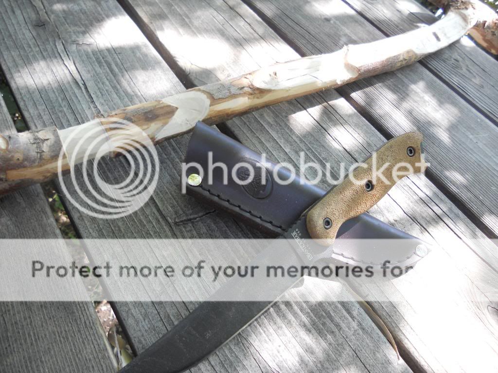

Agreed! You know...the 5 wasn't even on my radar until I picked one up at BeckerWest back in April. Since then, it has replaced most all of my kitchen knives (silverware excluded of course). It follows me on camping trips as well. It really can't be ignored!!
By the way Jon. That NixCustoms sheath is so sweet. In person it's even better. I want one!!!
