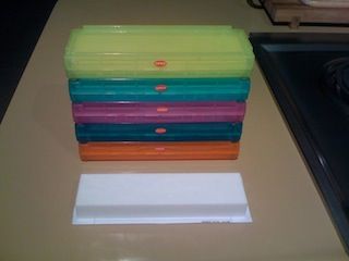

carbide grit hacksaw blade
That is how I SCORED these and broke them off of larger stones. Nortons.
AFTER I bought the Shaptons shown bellow. I had nothing to loose since the Nortons were made redundant.
Where'd you get the containers?
To the OP, if you should be successful in slicing the stones in half, then you would need to prop them up to give space above the surface so that your knuckles won't get in the way.
They come with the Shapton Pro stone.
I don't use them while sharpening, though they are designed to hold the stone on top of the closed box, I just store the stone in them. The box is vented so the stone can dry and not get mold growing on it.
Good stuff !
