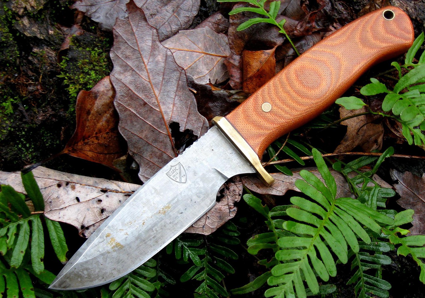

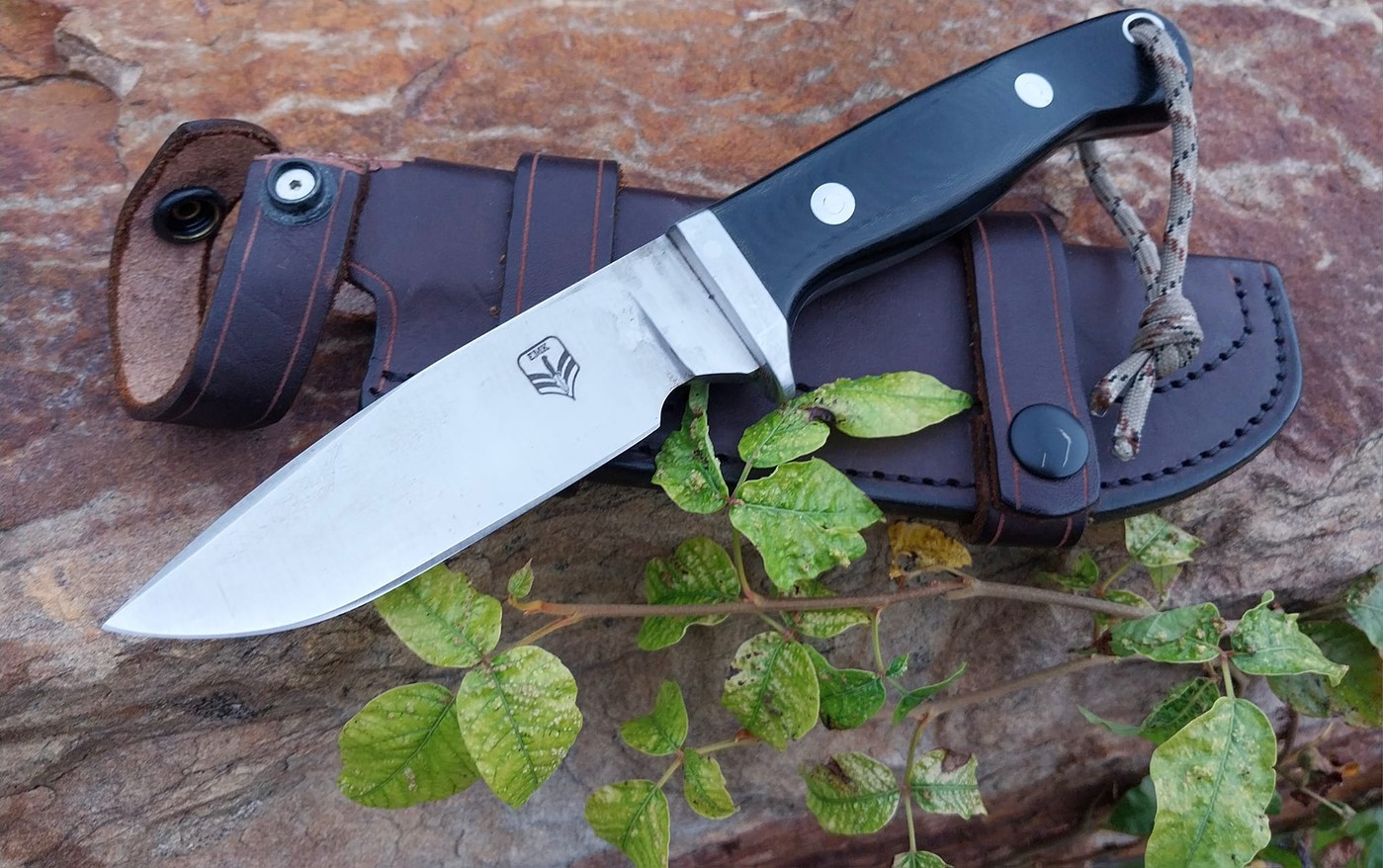

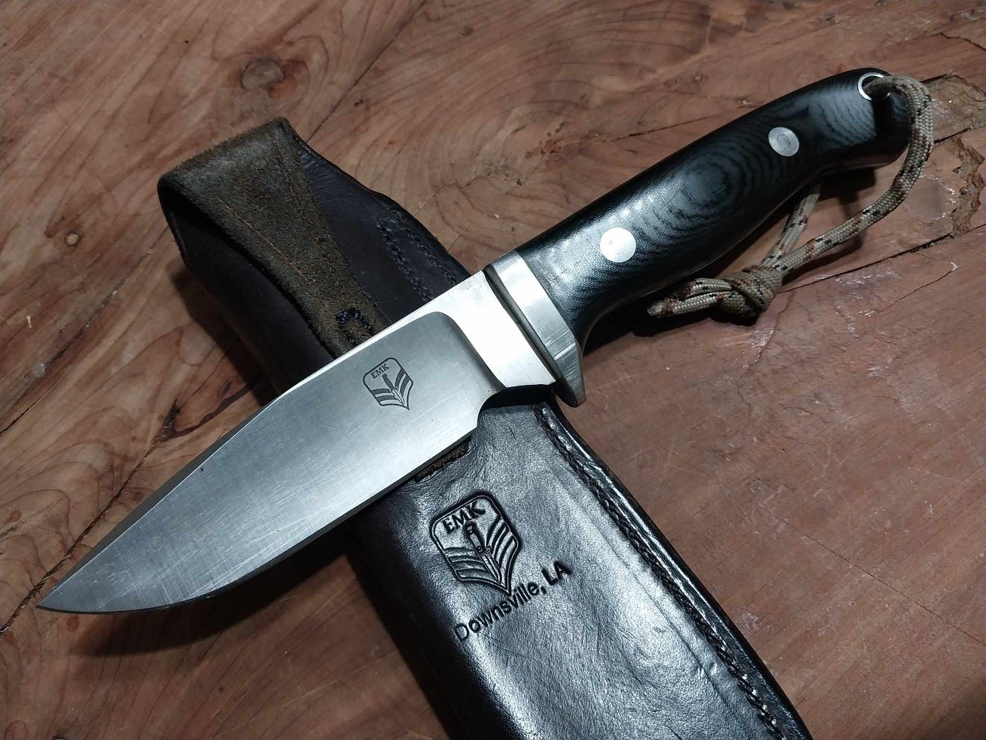

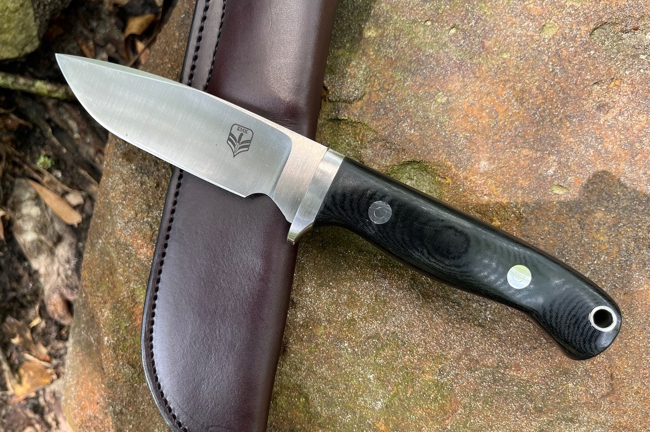

One of my first knives by Ed Martin was a saber ground Rio model back in 2012.
It was the first knife I used in the field, both as a cutting tool and as a size reference, in the course of starting the flora fauna database I was just beginning at that time
Sadly it was also one of many knives sold to fund surviving the crazy winter of 2013 / 2014 in Michigan, and I had wanted another Rio with what Ed refers to as a sow belly handle ever since. And was hoping for one with a stainless blade and a higher grind. Then a couple of years ago Ed posted this Rio on his website, in a nearly identical profile, but in CPM 154 with a deep hollow grind and a tapered tang, and I grabbed it without much thought before it could get away.
Ed posted a video of the batch of these on his you tube to warn us that they were deeply hollowground and not meant as combat or survival knives, though being a knife it could obviously be used as a tool for survival if needs be, but they were intended to be hunting and field knives. Yet when I got it home, after years of being hung up on knives I had chosen for their durability and intended uses in "survival" baded on my childhood experiences and PTS-driven train of thought, I wandered if it were maybe too deeply hollowground for my uses and if it would be too fragile.

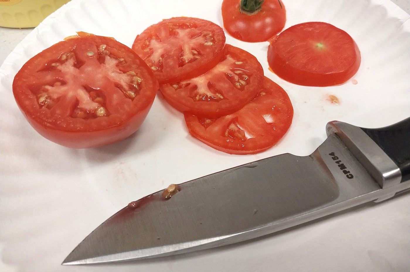

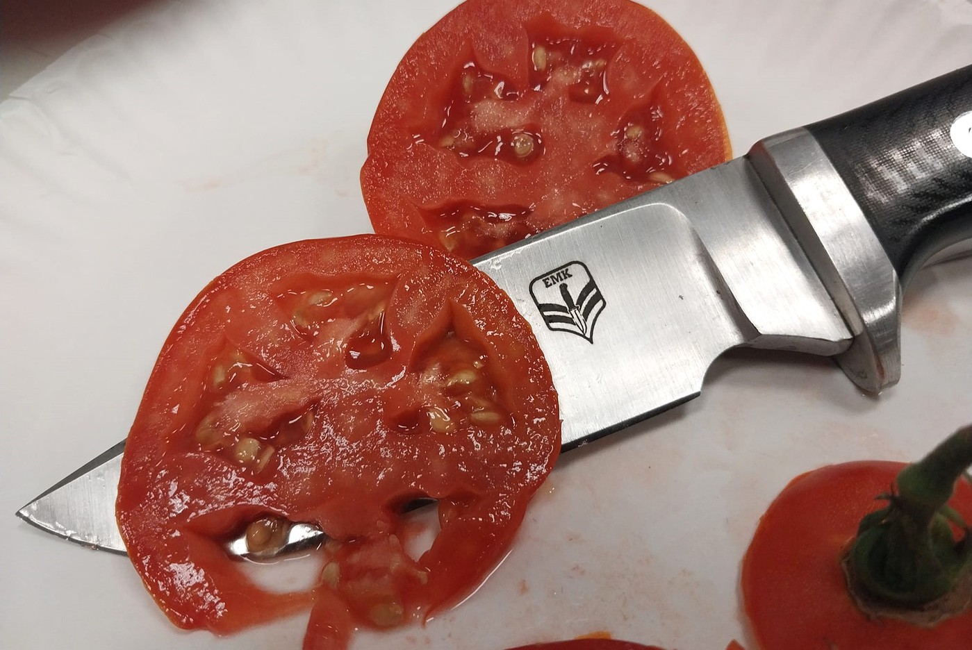

It definitely slices well

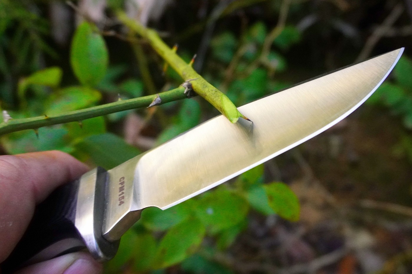

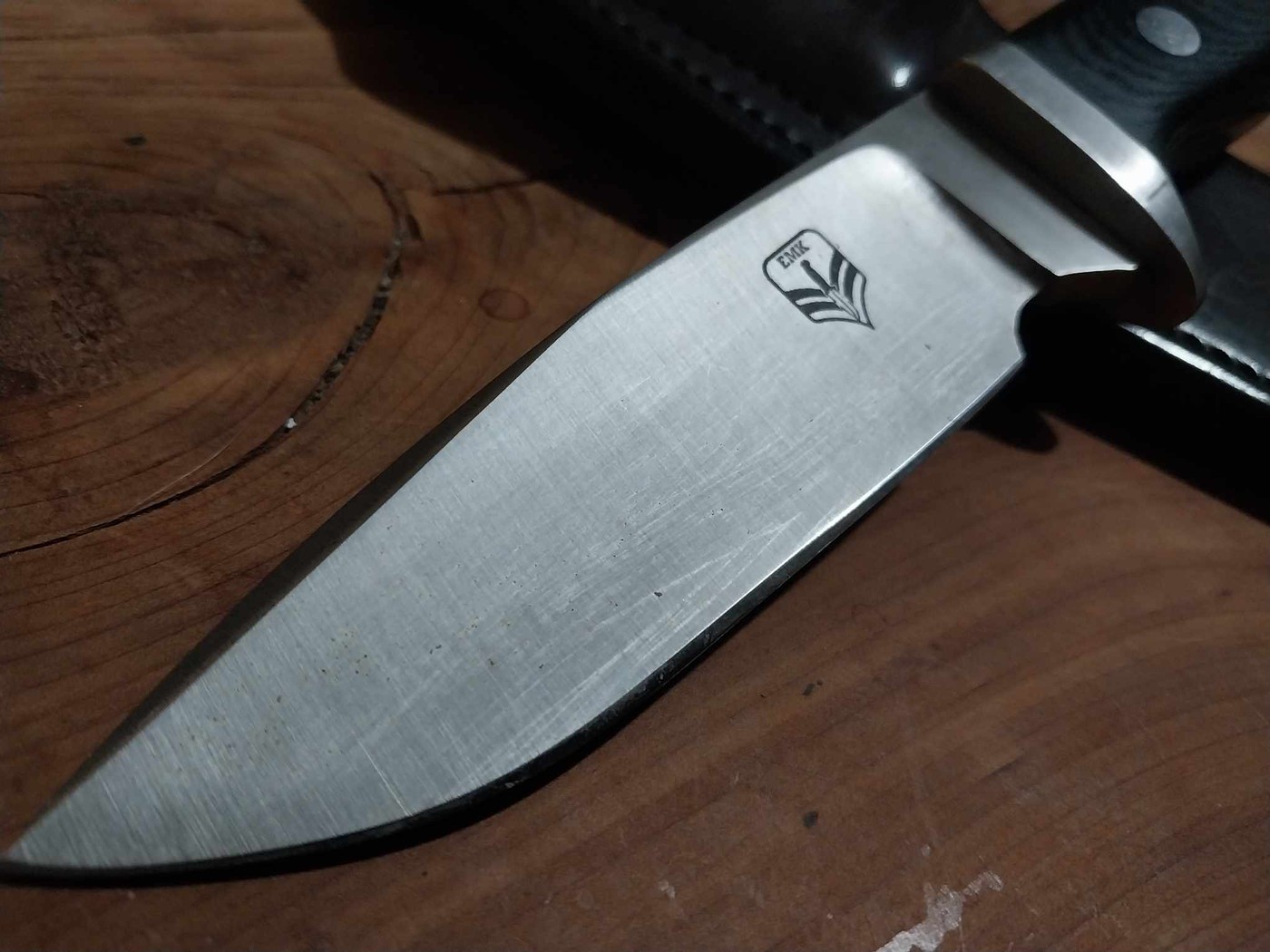

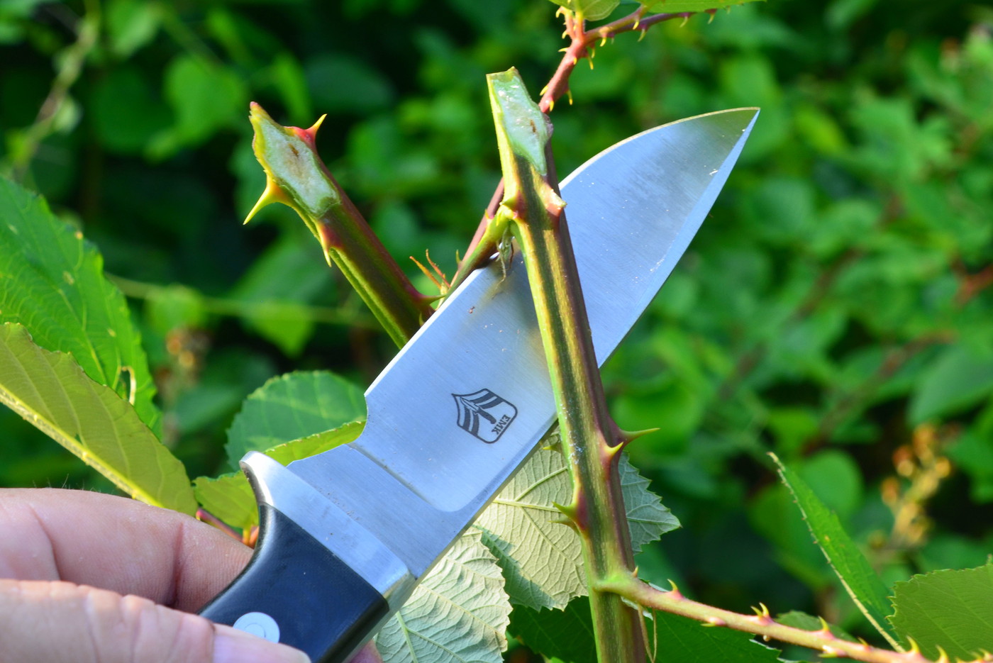

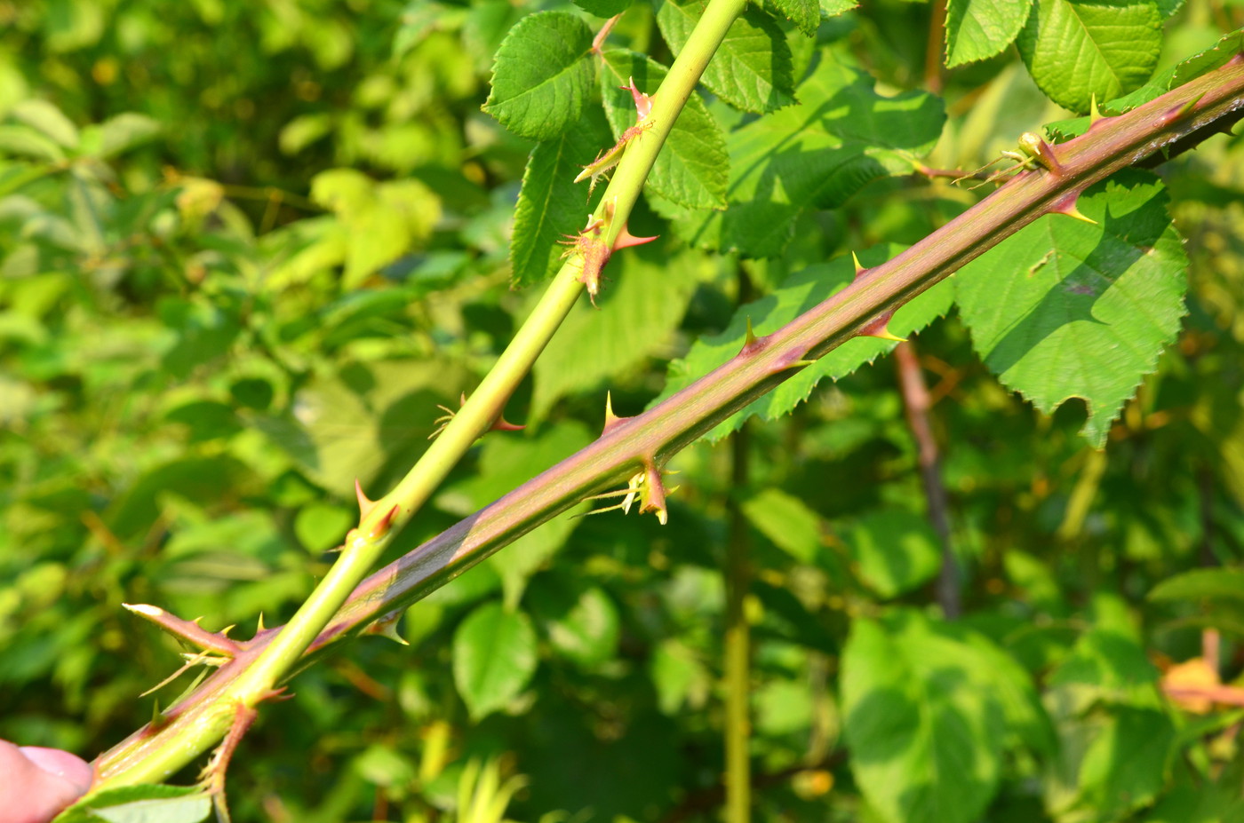

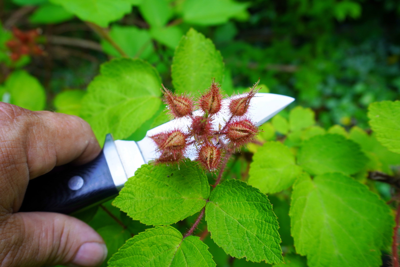

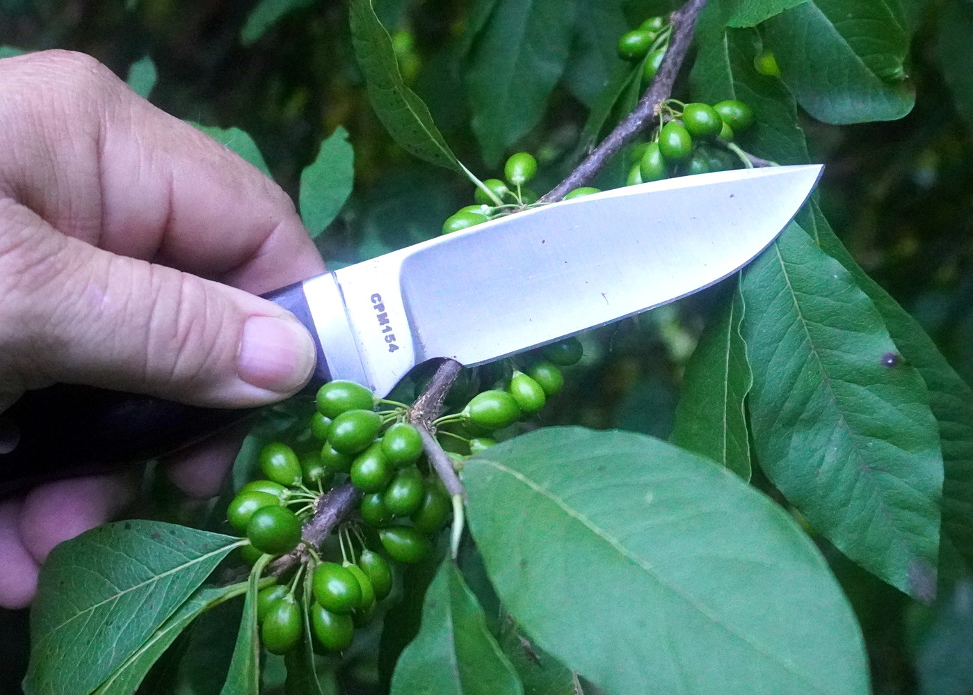

It wasn't until I got it in the field that I realized other areas where the geometry of this knife allows it to excel in my needs. One of which is in getting the briers out of my way as I make my way through forest meadows and fallow fields to collect my photos. We have a lot of briers here in this temperate rain forest. Some are very dense and hard.
But the mass of the nearly 1/4 in thick spine teamed with the hollow grind and the tapered tang, gives the knife a weight distribution that allows for great inertia development in very short distances of movement. So by holding the knife in a rearward three-finger grip, I can flick-cut through briers with minimal movement and minimal noise, doing less damage tp the plants in my path and not scaring off all the wild life and insect life I'm photographing. And makes harvesting berries easier.

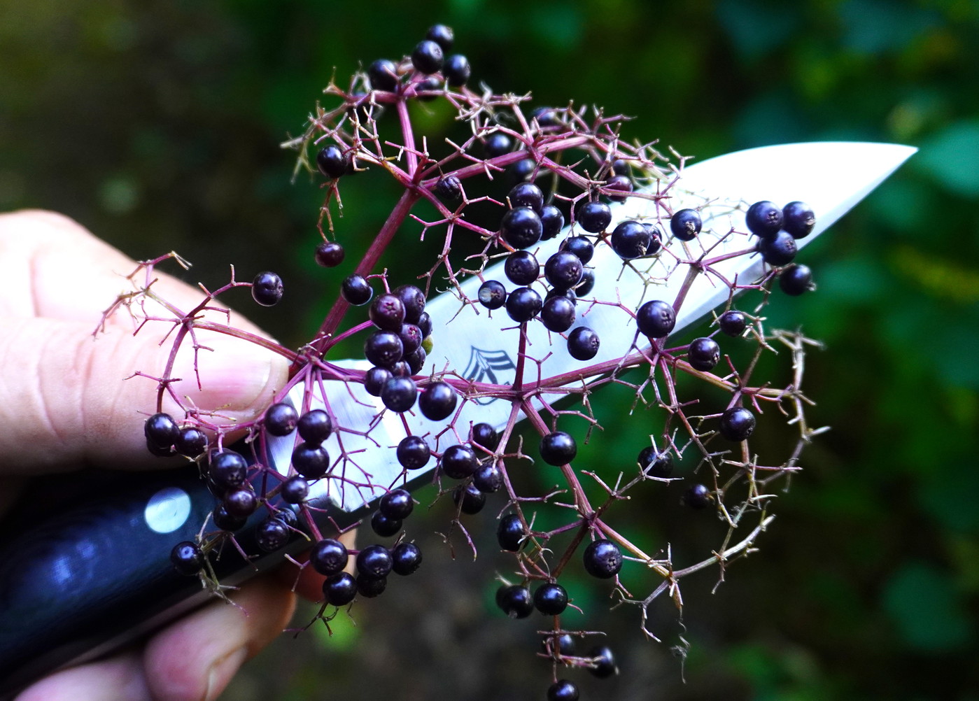

It also flick-cuts through plant stalks the same way, less force, less movement, less noise, less disturbing of the wildlife in the are. Great for harvesting Elderberries, for which there is a LOT of competition in the wild.

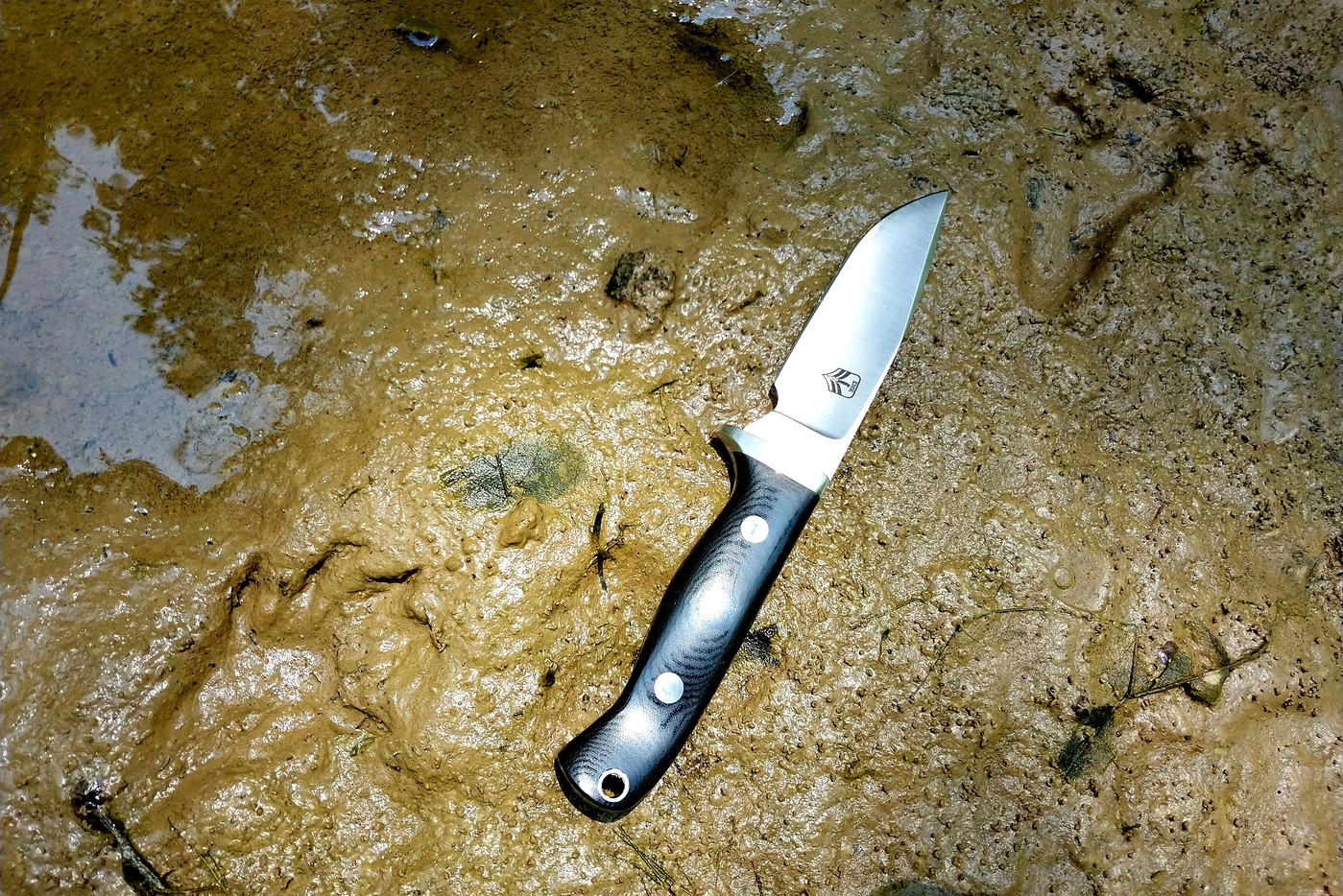

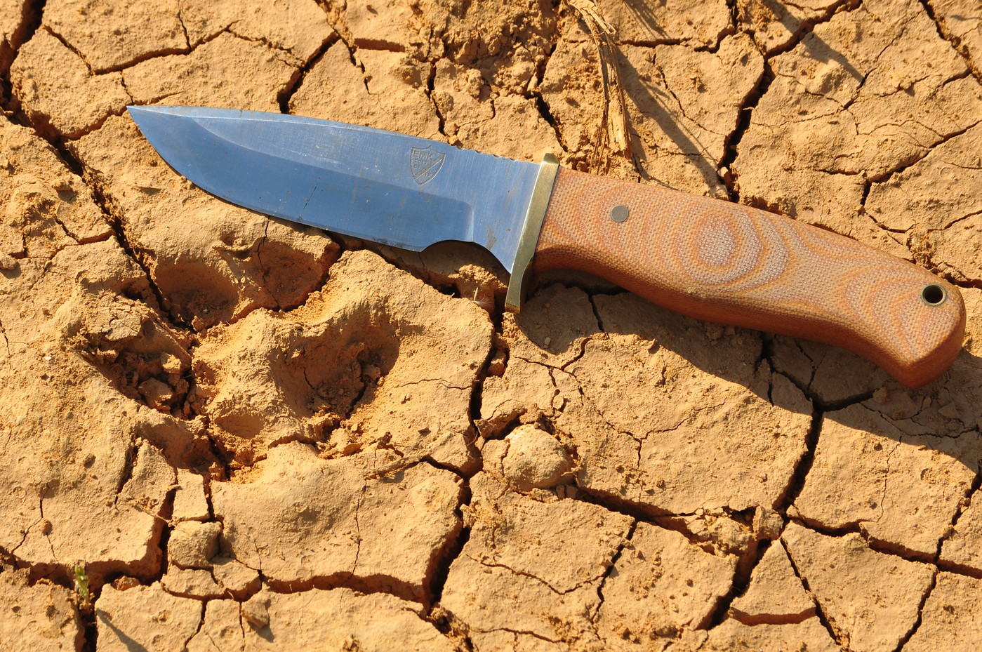

And I still use it for a size reference for tracks also, when I don't have my forensic measuring devices with me.

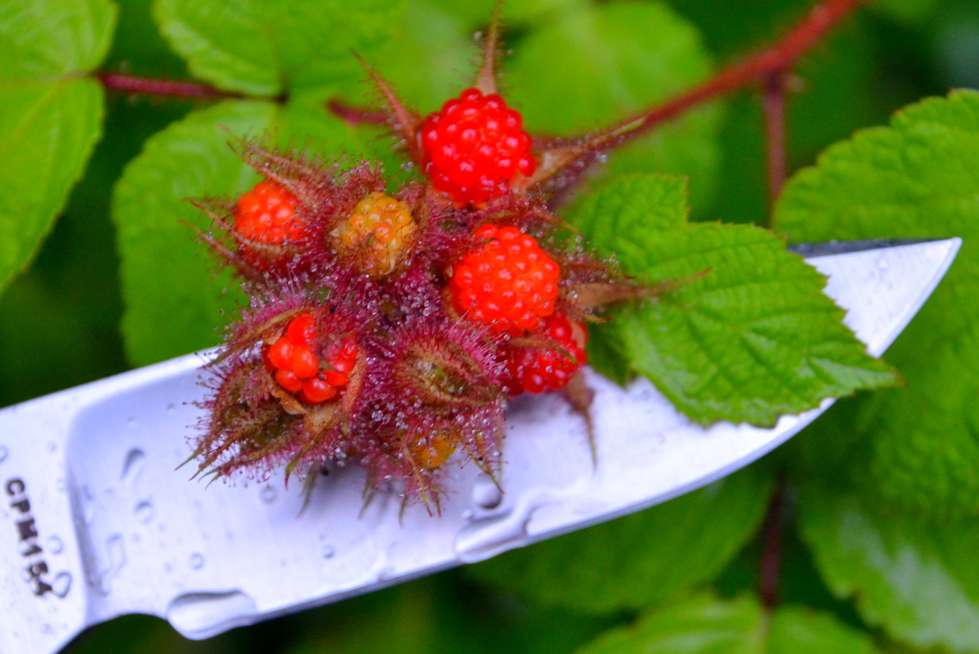

And as for the choil, I had noted years ago, with the first Rio, that it came in handy for manipulating fruit bearing branches into better lighting, giving me a way to hold branches in place that I may not necessarily want to touch, like briery branches or poisonous plants, and gives me a size reference with the blade length simultaneously.

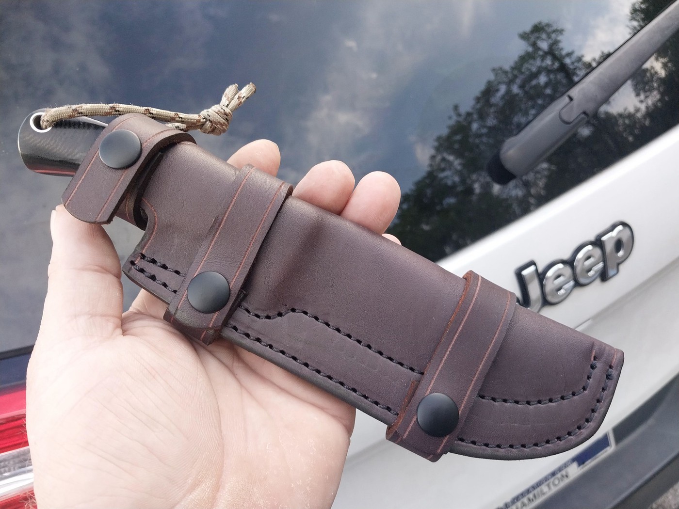

I had Ed make me one of his multi-carry / vertical-horizontal sheaths for it so I can carry it different ways to suit my needs at the time. And now, after all the intial concerns, this Rio has become the fixed blade I carry the most often and any time I am out in the field collecting illustration images or harvesting herbals.
