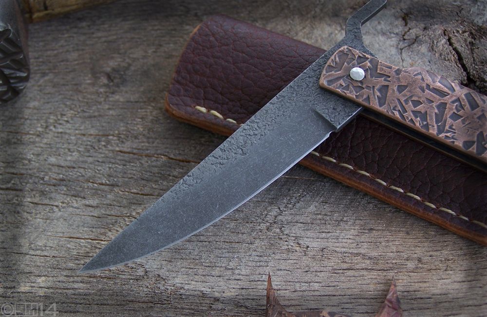

Just got around to getting all of these pictures together and thought I'd share some newer things I've been making.

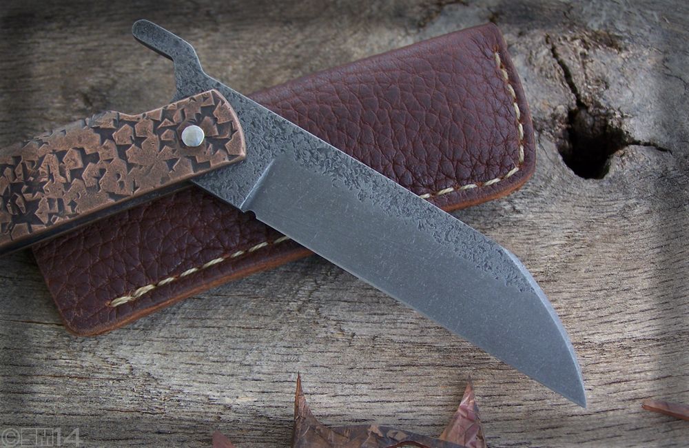

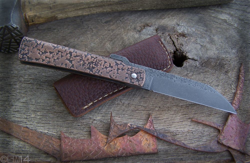

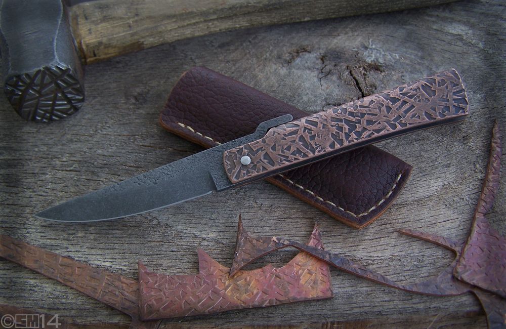

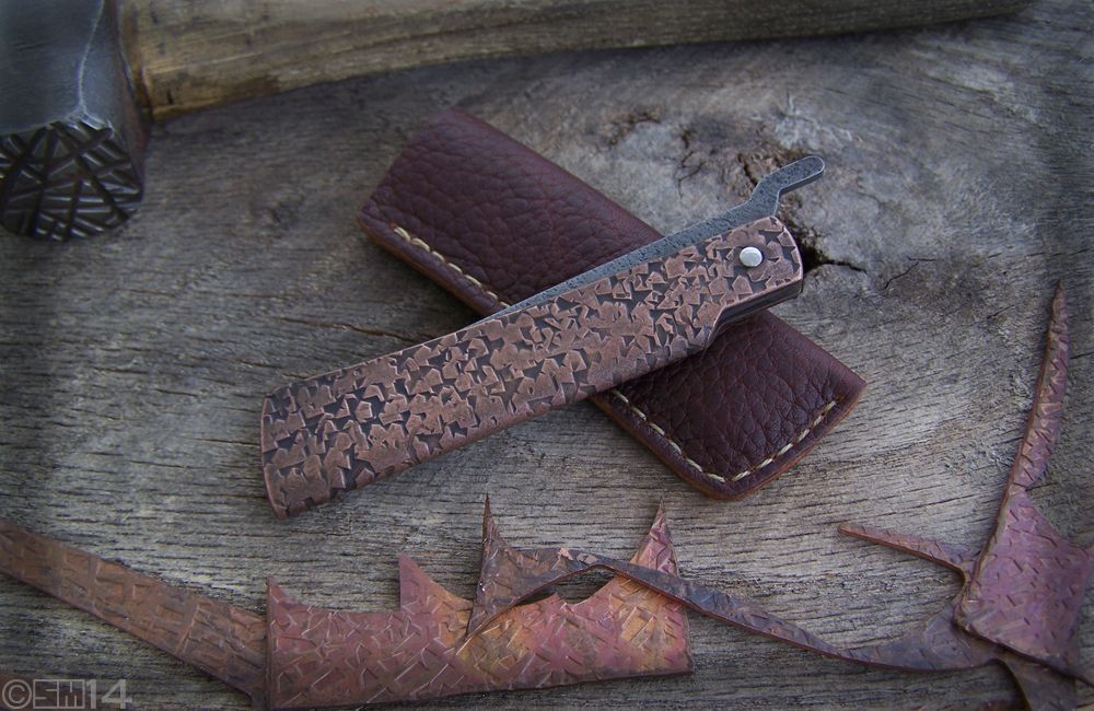

These first two are variations on some that I had done before,
but I wanted to see how stone washing the blades would look.
I think they turned out pretty cool.
Both are 1084 with copper handles, stainless pins and bronze washers.
6 11/16" open and 4 3/8" closed (including flipper).

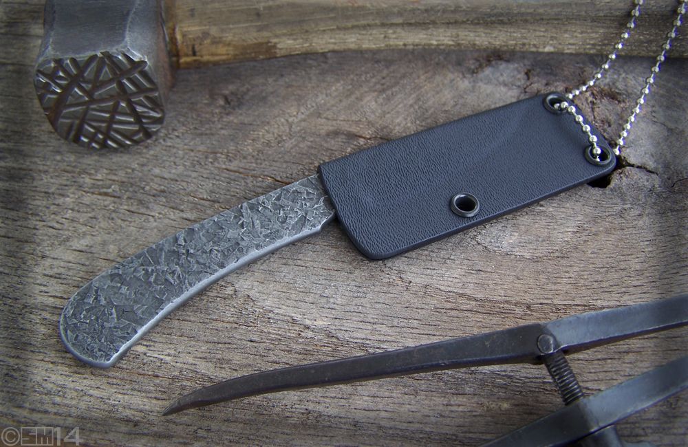

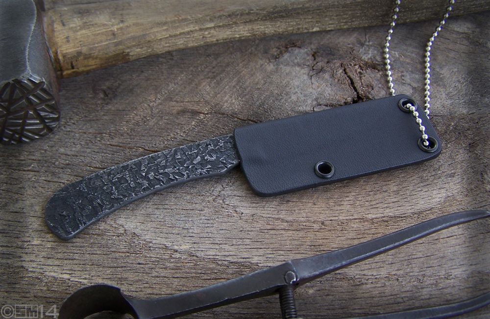

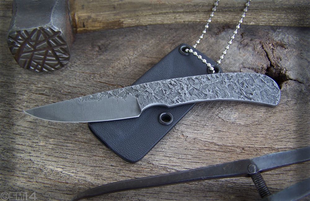

I've also been making a lot of neck knives.
These two are stone washed 1084.
The first one is 5" OAL with a blade just over 2" and a little under 1/8" thick.
I've also made some that are 4 1/4" OAL that I've been carrying as a pocket knife recently.

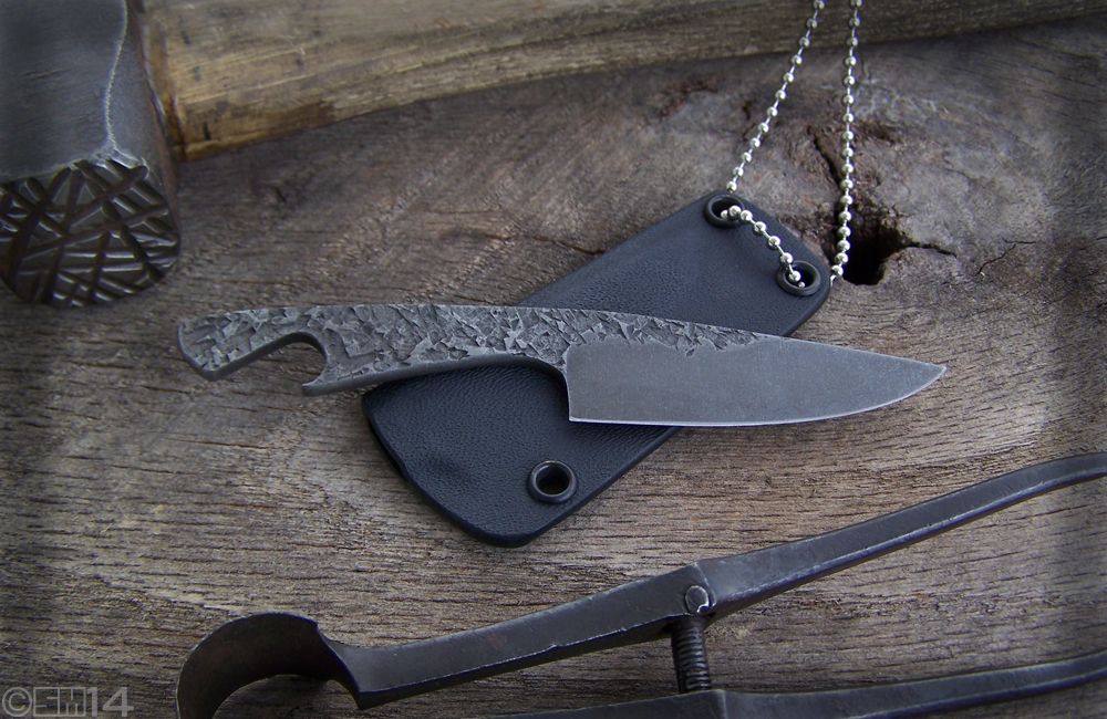

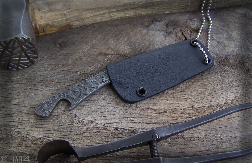

The second one is what I'm calling my "BottleNeks".
This one is 4 5/8" OAL, and the bottle opener is meant to be used when the knife is in the kydex sheath.
I also have a version that is an inch longer.

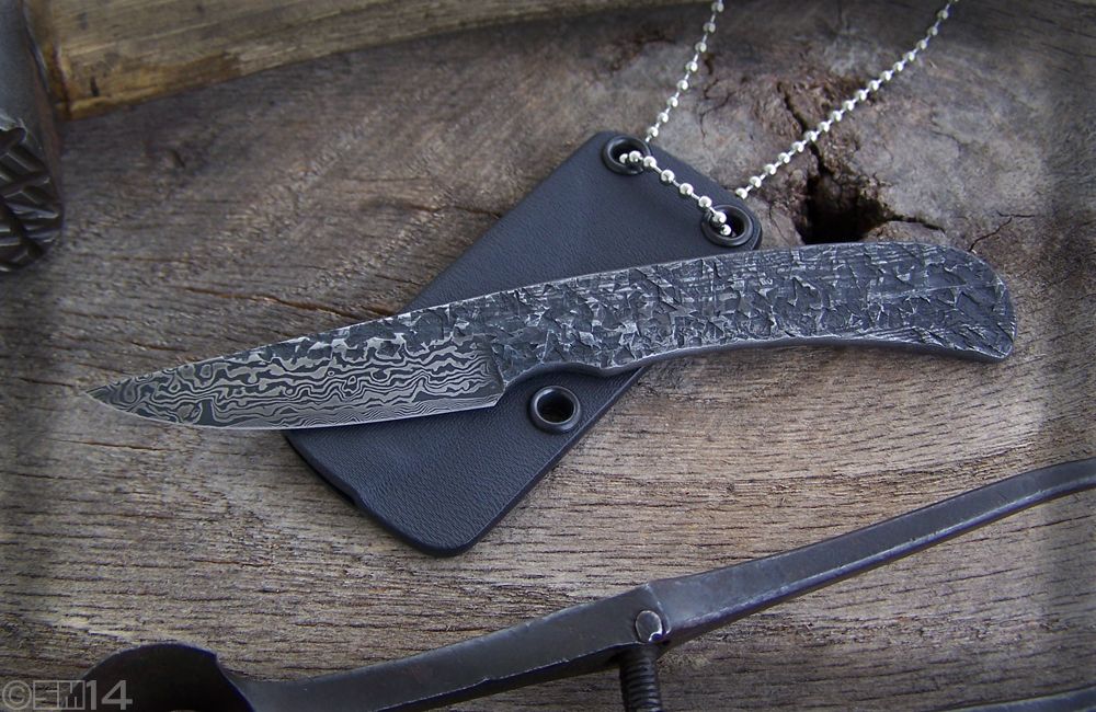

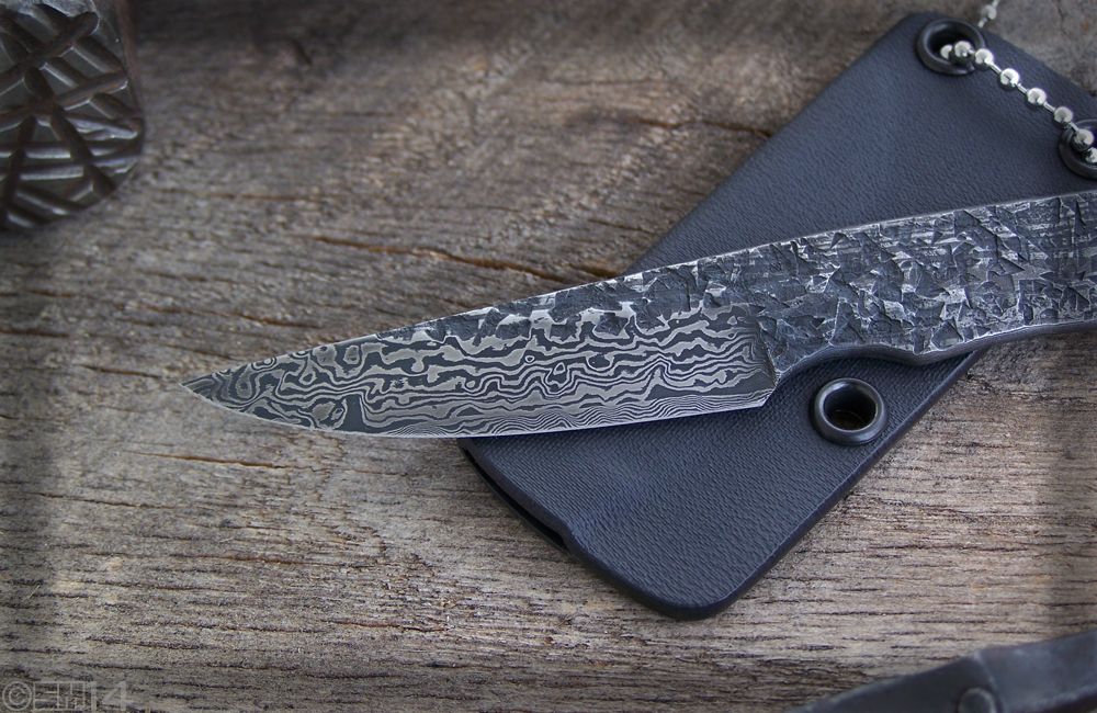

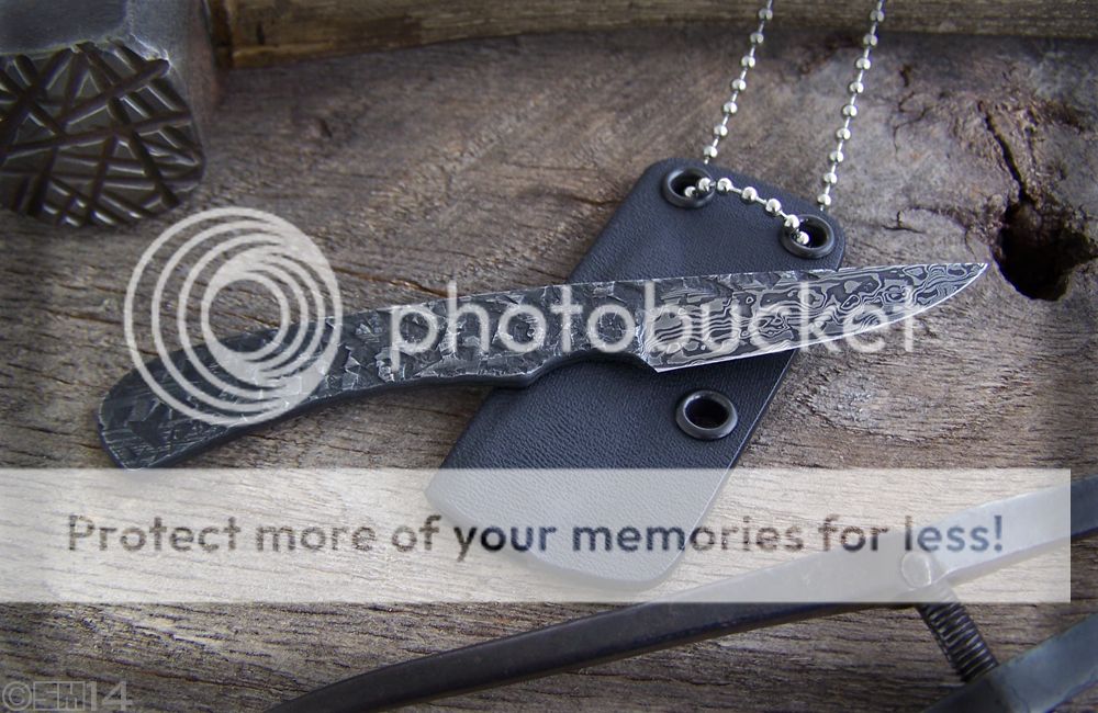

And these last two are the same as the others but in damascus and a little thinner.
The damascus I made for these is from 1084 and 15n20.
5" OAL
4 1/4" OAL
Thanks for looking. Let me know what you all think.
