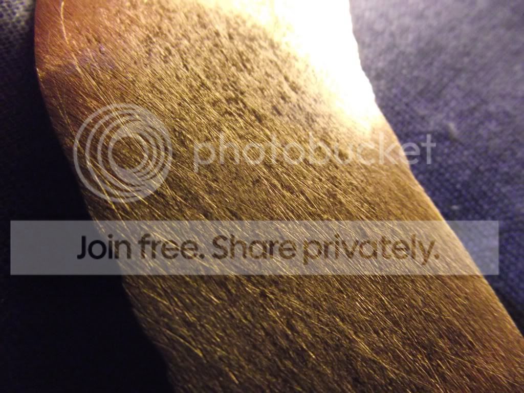

that vinegar trick worked great, except that it worked great. let me explain. almost all the scale is gone, but i got some pretty severe pitting along the spine. should i have decreased the amount of time that it was in the vinegar? it was in there for about 12 hours this time.

The pitting probably did not come from the vinegar — it just isn't an aggressive enough acid. It may have come from overheating or from not removing the scale during forging, which can drive the scale into the softer steel and produce pits. To deal with scale pitting, either brush your steel periodically with a steel wire brush or forge with a wet anvil.

there is one problem. i didn't forge this. this a stock removal blade. how could it be caused by overheating?

Silly question, but was the steel rusty? I don't think heat will bubble the steel...Unless you hit 1800 plus. I don't really think the vinegar is aggressive enough to cause sever pitting. Can you post a picture?

Mike, the steel was not rusty as far as i could see. The pits were not deep, and so i am going to assume that they were just part of the scale. also, they were only on the parts of the blade that had not been ground. i will take the scale off first thing, next time. as far as pics go, i will see if i remember to get some up tomorrow. the pits are coming out with sandpaper and time, though.
look towards the top, there you can definitely see them.
as you can see, these pits go down to the metal. I removed all the forge scale, and they were still there. they came out with sanding, but i am not a happy camper. I do have a question. Do you think it matters under the handle? i am going to remove it from the blade section, but i figure that it should be fine under the handle. shoot, it should allow the epoxy to grip better. thanks for the help. Steven
