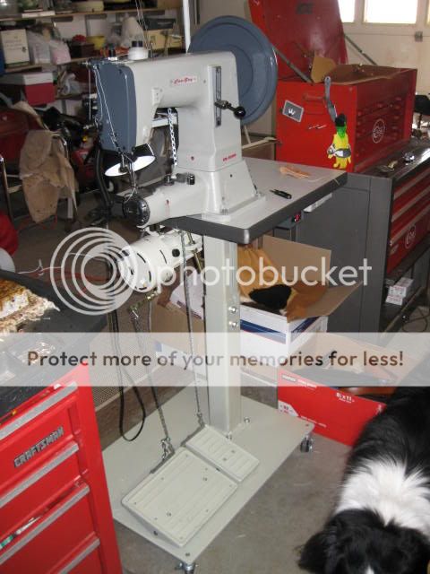

As long as you're researching, here's one you should be aware of.
I've had my Cowboy 3500 for about a month now, and the honeymoon is still going strong.:D
It's rated to go through 3/4" and I know it will do so because I've done it.
Most of my projects are 2-3 layers of 8-10oz and it makes very short work of them. What used to take me 45 minutes to hand-stitch, now takes me 5.
I'm no expert (yet) on this machine, but as I understand it, several of these 441 style machine are basically the same with interchangeable parts,( Cobra, Juki, Singer, Artisan, Cowboy, to name a few).
This CB3500 is a 9-1/2" arm....their 4500 is comparable to the Cobra Class 4 and the Toro 4000 if I'm not mistaken.
The dealer who sold it to me is only 1/2 hr from me, and readily available on the phone so that makes it nice for me too. While we've become fast friends, I haven't had to bother him too much, but it's nice to know he's there!

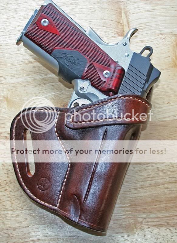

Here I've got it set at 6 SPI and it's almost as nice as my hand-stitching...:D
And another thing........I actually went to this dealer hoping I could find a used Boss (he carries many used machines), I was really sold on them. After hand-stitching daily for 5 years I figured it (Boss) would be quite the up-grade.
And it would have been....but when he demoed this Cowboy, for $500 more, it was a no-brainer decision......not that I had the extra cash laying around, I just had to wait another month or so before I could bring it home.
