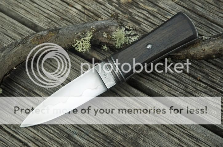

I just finished up this sheath for a Sgian Dubh I made recently.
It was a lot of fun figuring out the knot and dragon.
And here's the knife in case you're interested.
What do you use for setting the little rivets? My setter is the one used for snap closures and it doesn't really work that great for these little dome rivets.
