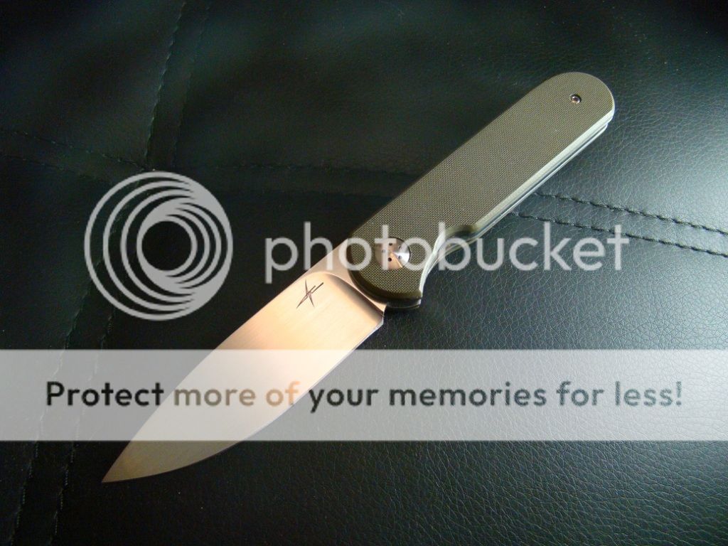

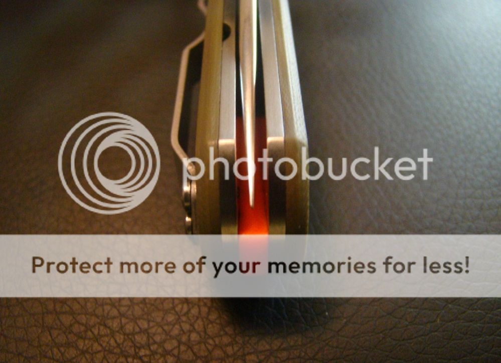

Hey all
Just finished up the Shamwari prototype (Weekdays for orders, Saturday for the Wife - Sundays for me to play!) I went with a linerlock setup so I could see it all together without having to wait on the engineers to mill the pocket for the lock protector (don't have my own mill - yet).
Specs:
Blade: RWL-34, high hollow satin finished (it's ground with a 450mm diameter wheel so it's a pretty shallow hollow, should slice like a dream)
Scales: Textured Olive G10
Liners: 2mm titanium
Backstrap is Orange G10
Stonewashed pocket clip
I radiused the spine, really happy with how it came out, I really like what it does to the jimping :D I'll try get some better pics in the morning, just gone midnight here and I was too wired to wait so please excuse the photography.
Anyways, photos say it better:
You can't see it here but the spine sits proud in the open position but flush in the closed, it makes the jimping a little more accessible and the radius means it's not too aggressive on the thumb (you can see it in the vid though)

Looking really awesome. I'm sure some liner lock fans will want a spin off of your latest prototype. I'm just caving the frame-lock on order. All the progress is reassuring and pleasurable to see. Keep up the great work.
KG
Looks amazing! The finish on the blade is really nice. I love rounded blade spines, and yours looks great.
