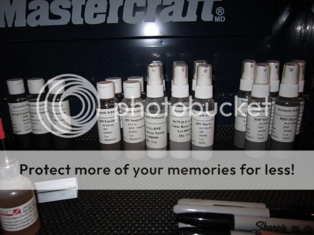

Which diamond sprays do you have?
I use Kanagaroo , it works excellent. When used on the EP it actually creates a stiction to the edge that helps burnishing. I use my Kangaroo with CBN and my Nanocloth with Polycrystalline.

I have 6 and 3 micron dmt paste along with 1 and .5 micron hand American paste and one bottle of .25 diamond spray. Although the .1 and .025 sprays do look appealing for the future, down the rabbit hole haha
Yeah , they are fun...
I have one bottle of some stuff even finer than 0.025 coming :) , and some unannounced stuff.
Ahhhhhhhh do tell do tell!
Also, that's a huge jug if nano oil! Looks like a nice sharpening station.
