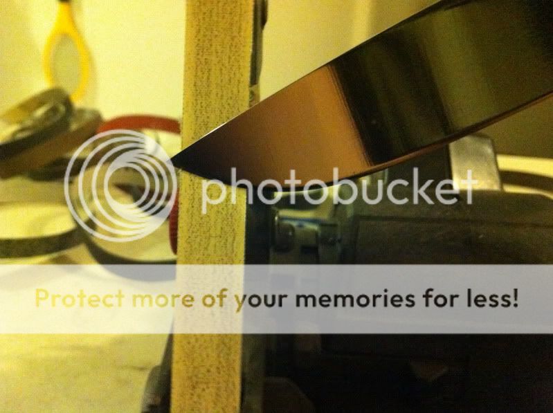

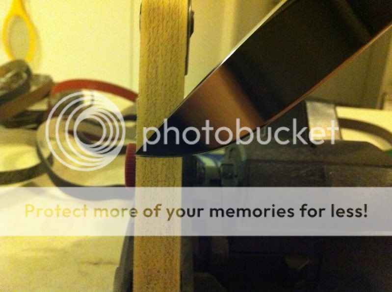

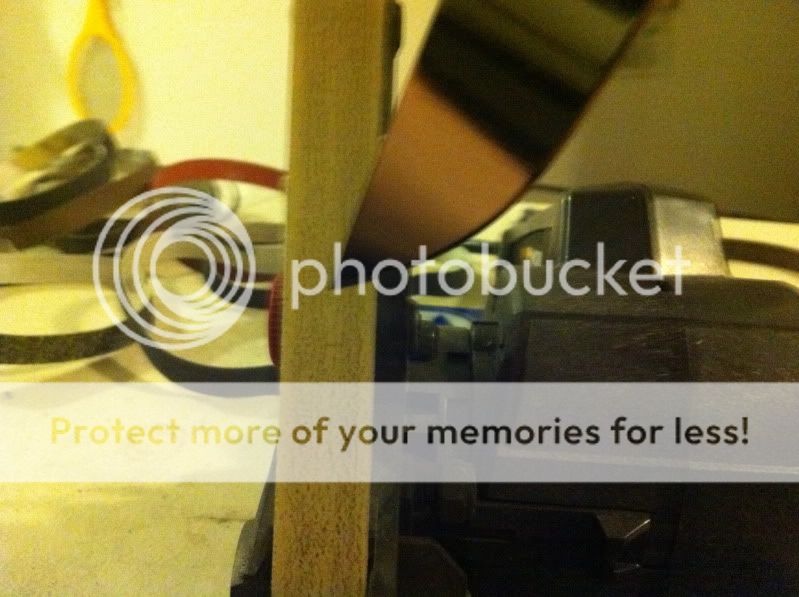

As for the tip issue, you need to follow the curve of the blade as others have said, but I believe this is better demonstrated with pictures. These pictures are with a mini-belt sander, but the idea is the same.
This position will leave the tip untouched and over time will mess up the curve of the blade. This is what I suspect you're doing.
This position will round or dull your tip.
This is the "correct" position and will sharpen your tip without rounding it off or altering the curve of the blade.
The idea is to keep whatever part of the edge that is touching the stone perpendicular with the direction you're sharpening.
^That, in a nutshell, is the way I go about it. Especially when near the tip.
I'd recommend (HIGHLY) using a magnifier. At least 10X, and under very bright light. You can learn a whole lot about what's going on with your edge, simply by taking a very close look at it. Use a black marker to darken the bevel before you start, so you can see where the ink comes off and, therefore, where you're making flush contact with the bevel. Make sure to use that magnifier, when checking for the ink. The tip is probably the most likely place to miss making flush contact, because the edge angle is usually quite steep there. You'll keep seeing a thin line of ink near the edge, in spite of it being removed everywhere else. So, patient, observant persistence is key, when doing the tips.
not sure about that. and nt sure i'll be able to make a clear point in english but i'll try.
keeping the edge perpendicular to the direction of sharpening is important for the direction of the scratch pattern. but you can hold the edge 90° to your stroke and mess up the angle. it's not related at all. when sharpening on a stone i never have the edge 90° to the direction of the stroke. more 60-70 in the straight portion and i try to keep this angle when getting to the tip.
imho what's important is lifting the handle or when working on a vertical belt pulling it toward you. if you keep the edge 90° to the stroke/belt direction but don't lift the handle you tip won't contact the surface of the abrasive on the tip or just the corners. same if you lift it too much, you'll round the tip.
This is why I always recommend inspecting the edge with a magnifier. At good, well-illuminated magnification, it becomes glaringly obvious if the angle isn't right, especially at the tips. Seeing the ink remain at the edge, while the shoulder gets slowly ground away, is the obvious indicator to lift the blade as you get nearer to the tip. In the early stages of learning how to sharpen, before one has developed a true feel for it, I truly believe that seeing is believing, in the sense that if you actually see the results of what you're doing, close up, correcting your errors in technique is much easier & intuitive. I know it was for me.
